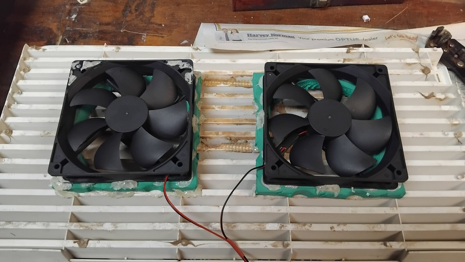

Some upgrades for Big Mal, lashed out on 4 x 120mm fans so new fan in ensuite after vent rebuild, new fans at back of fridge, went from 3 x 75mm jobs to 2 x 120mm, a couple of leds to replace the last 2 fluro unit inside which were hardly ever used, with the price of new fluro tube may as well buy a whole led light fixture, along with new door seals its all ready for a run in a few weeks again, diesel heater is working well and I have hopefully found a sealer for the rubber checka plate stone guard on front, tried all sorts of tyre protection stuff but all only lasted a month a most, this time an acrylic paint sealer, 3 weeks now, lots of rain and its still good, rubber looks like new ........................

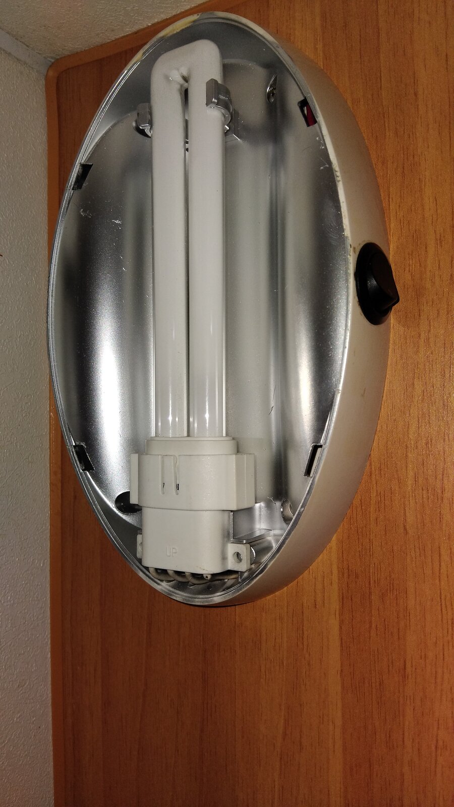

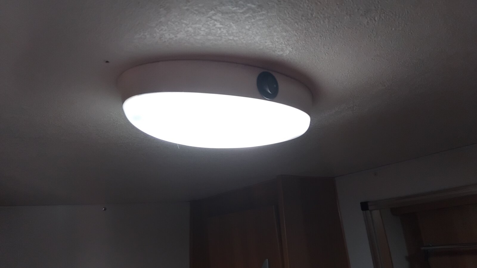

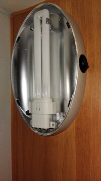

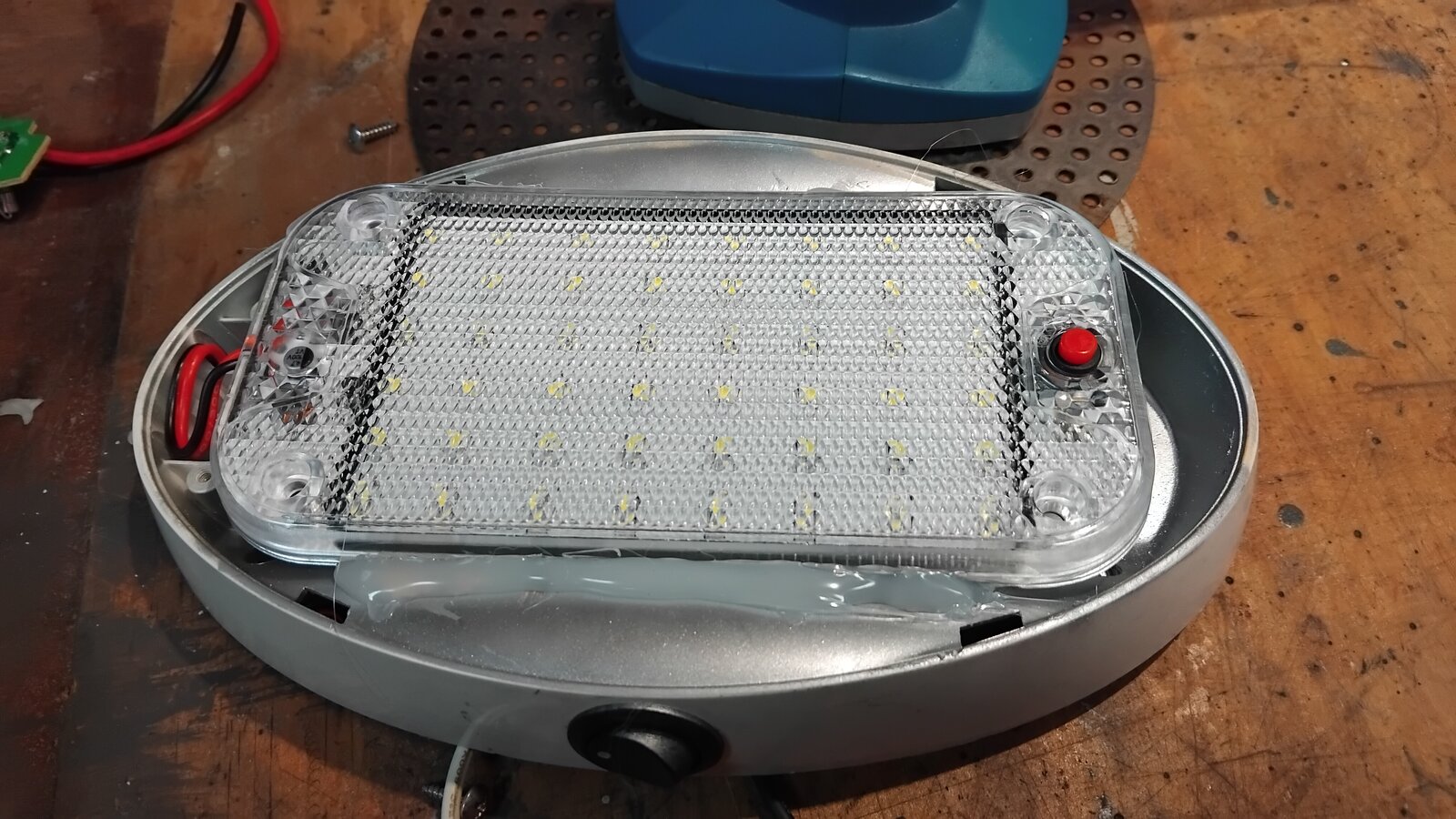

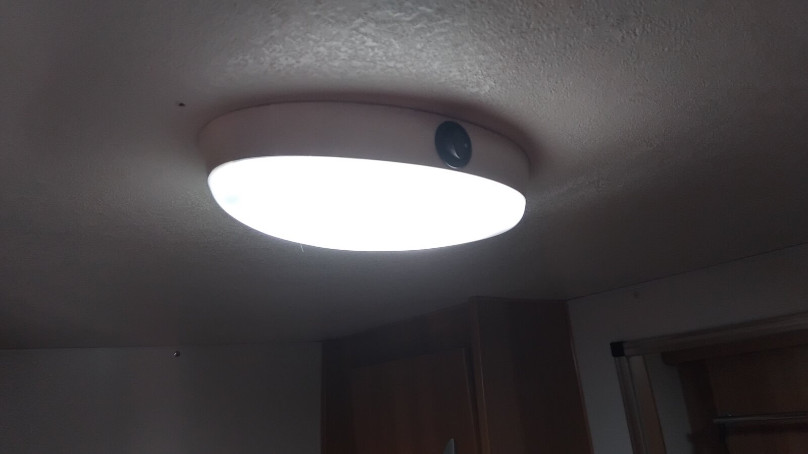

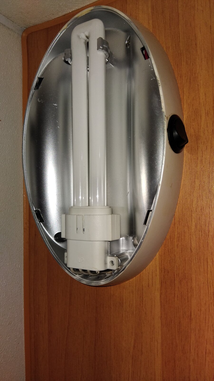

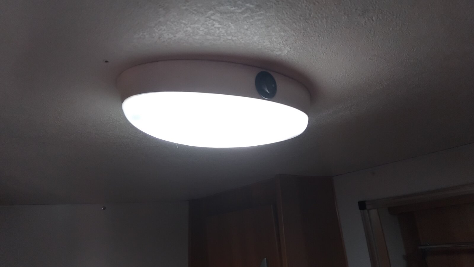

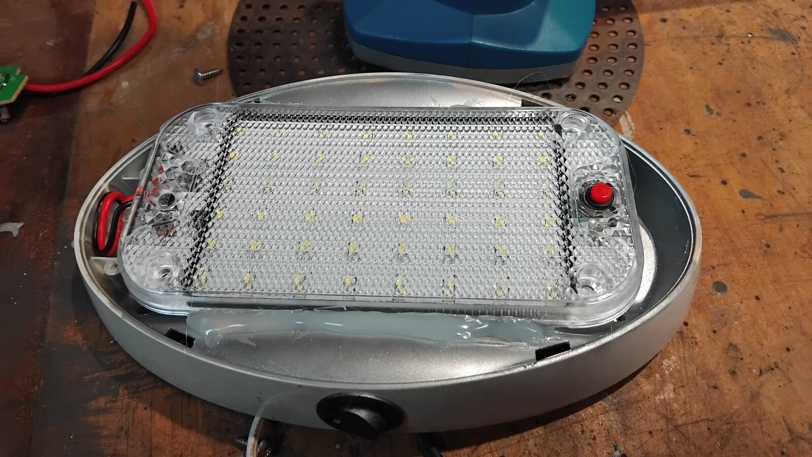

My new led lights turned up today, :applause:, it wasn't long till I discovered something amiss in my grand plan, the size of the Led's was smaller than the old fluro light fitting andsome of the screw holes were showing along with a bit of cabling, bummer but I found a cunning plan, remove the guts of the fluro light and glue in place the Led unit with it turned ON and wired up to the original switch with original light diffuser in place, looks like the old lights but far brighter and can see much better ............... All up $20, the other fluro's in the rest of the van replaced years ago and the same fittings are now $80 each so not going there ......................... new fluro tube if you can find one is about $25-30 and no led lamp with compatable socket ............
PS: I should add even the cunning plan did have one hiccup, once I had glued the led panel in place I noticed I'd covered the holes to remount the light, another slight mod required.....................
IMG_20250605_135622.jpg.. Original light ............................ Modified to LED .. IMG_20250605_133746.jpg

Yes Ian @Drover, modification at its best despite the many challenges along the way. No need for the reflective surface behind the light any more and the LEDs are far brighter and use less power too. Something to be proud of indeed!!!! Great job and very neat!!
