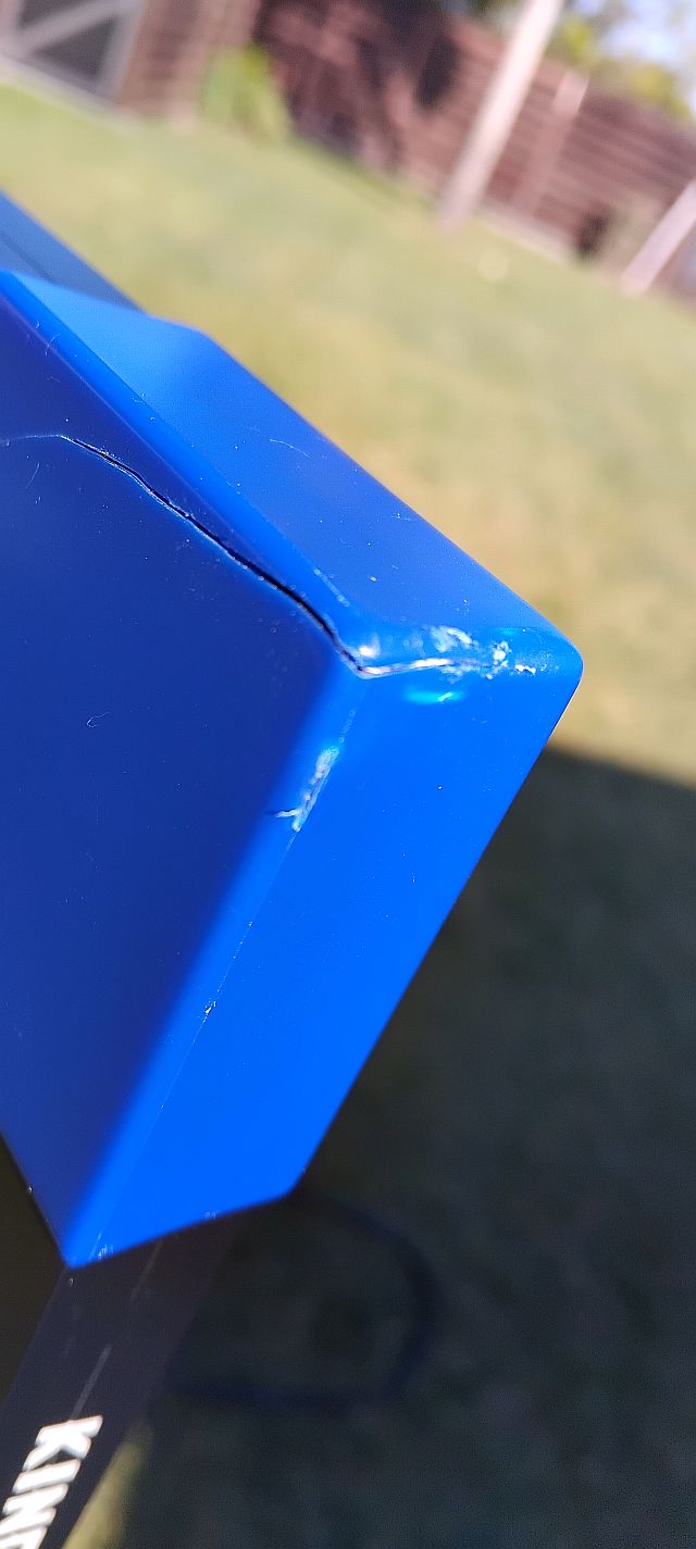

Well so much for the run of good luck this week, the panel was DoA, bummer, before stuffing around with everything I put it on the meter, didn't look right so connected it all up via the portable anderson connection on van, so with a VoC of 21.85 its showing 24v and when connected to the controller its also showing 24v, it shouldn't be so me thinks its stuffed, no charging current either as I think the controller has locked it out ...
Tested on the Utes set up and the same so its stuffed ....
Now we go on the send me another one trial, main reason I hate mail order and much prefer to buy direct from shop but in this case the shop is a couple of hundred kms away ............ (insert appropriate adjectives, lots of them )

A couple of emails yesterday ,Kings gave me 3 options return by Post they'll send a return voucher, have a Courier pick up from me or do a swap from a Superstore, the first 2 would take a week or so to be resolved with a new one and then taking your chance someone doesn't drop the thing again, so a 260km return run to nearest store on sunny coast is the best option ... Barcode all printed out ready for pick up later today .............. Fuel in Gympville at $2.69 and I don't care, Ranger needs a nice run to clear the soot....
So much for the savings on freight but proved my thoughts on getting panels in the mail. Kings was very quick and easy to deal with, no stress....here's the pic I sent them of the damaged corner.....
