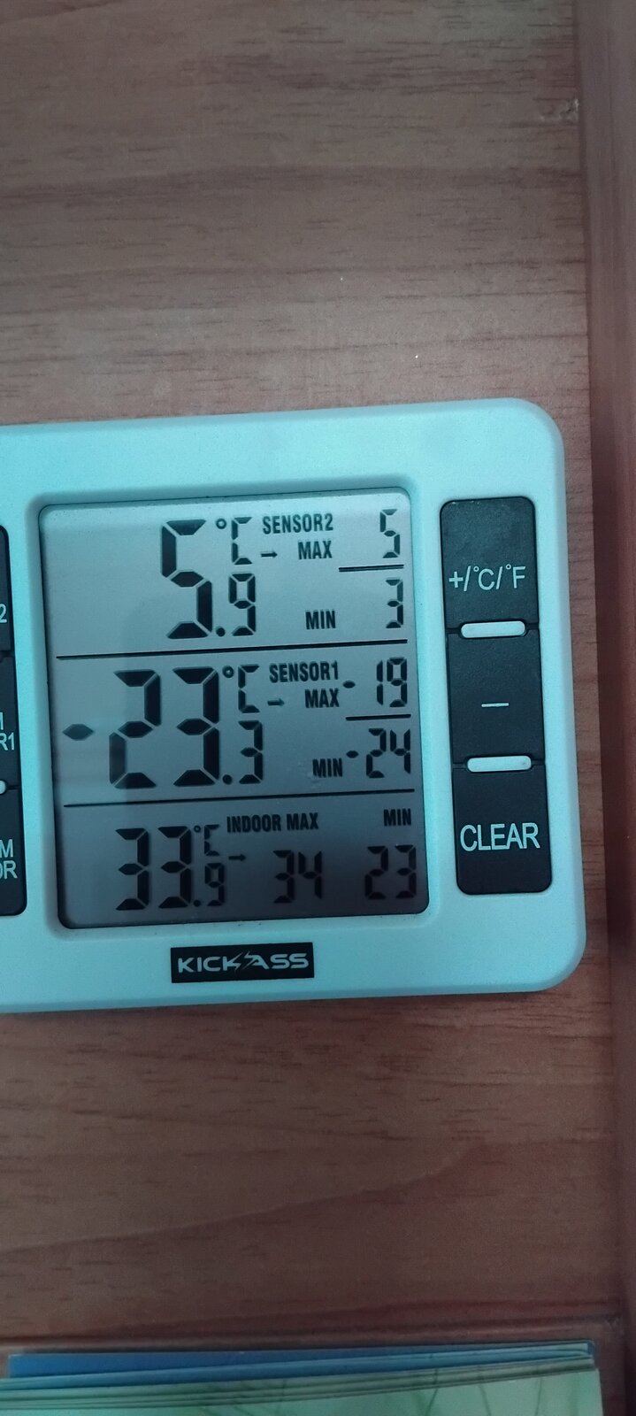

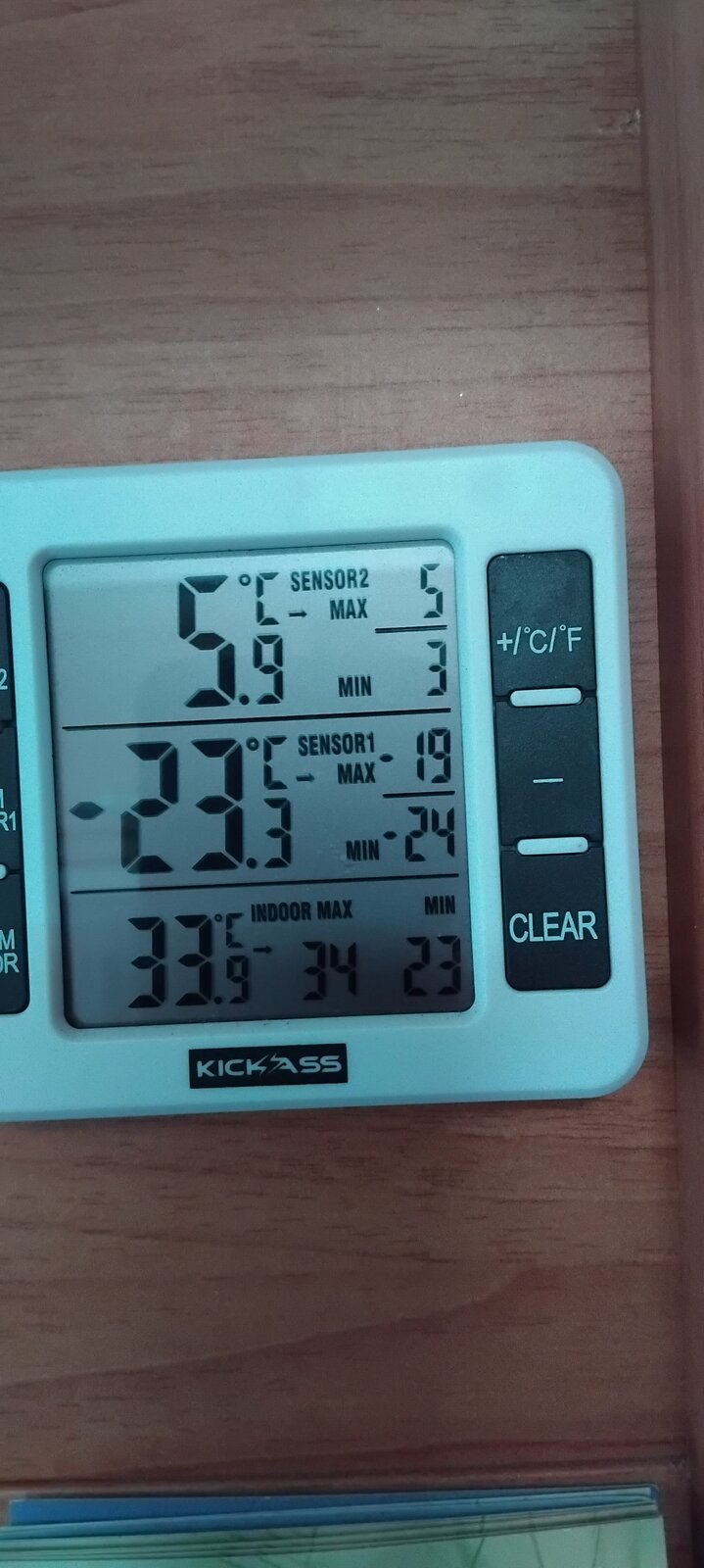

This is why I bang on about doing a proper job on your fridge insulation ..... Happy hour so fridge door has been working with nibblies,wine and beer extraction, it's 32c and my 3 way insulated properly shows that they do a good job when installed properly..something the manufacturers can't manage..... no screen on the outside either as the outer wall is fully insulated...
I have to head home soon...bugga. fridge at 5.9 freezer at -23..... perfect.
@Drover , it is not the manufacturers of the fringes, it is the fridge/van installers who do NOT install fridges in the vans correctly, and according to the instructions of the manufactures. If installed as per instructions, absorption fridges DO operate as advertised. Yours seem to be operating well in more than 33C ambient temps and the fridge section has only a small operating range of only 2C despite being opened a fair bit!!e. Mine operates similarly too. External fans make a big difference and most of the later models of these fridges have fans both inside to provide even temperatures and prevent freezing the lettuce, tomatoes and cucumber, and eternal fans to remove the heat from back of fridge.
13,285
20,096
I was referring to the Van Manufacturers not the fridge builders , I have looked quite a few fridges and few seem to be fitted properly, biggest fail is the outer wall insulation usually consists of a 1/2" panel of styro that hardly covers the area, have refurbished about 5 of them so far and they are all running heaps better, my current new job has a fan at the back but like most it only kicks in when ambient is 35c which I reckon is too late my fans at the top fire up when the tubes reach 55/60c forget which , I haven't managed to find a happy position for the internal fan so it stops the ice age on the cool fins........... but the lettuce doesn't freeze so all good....

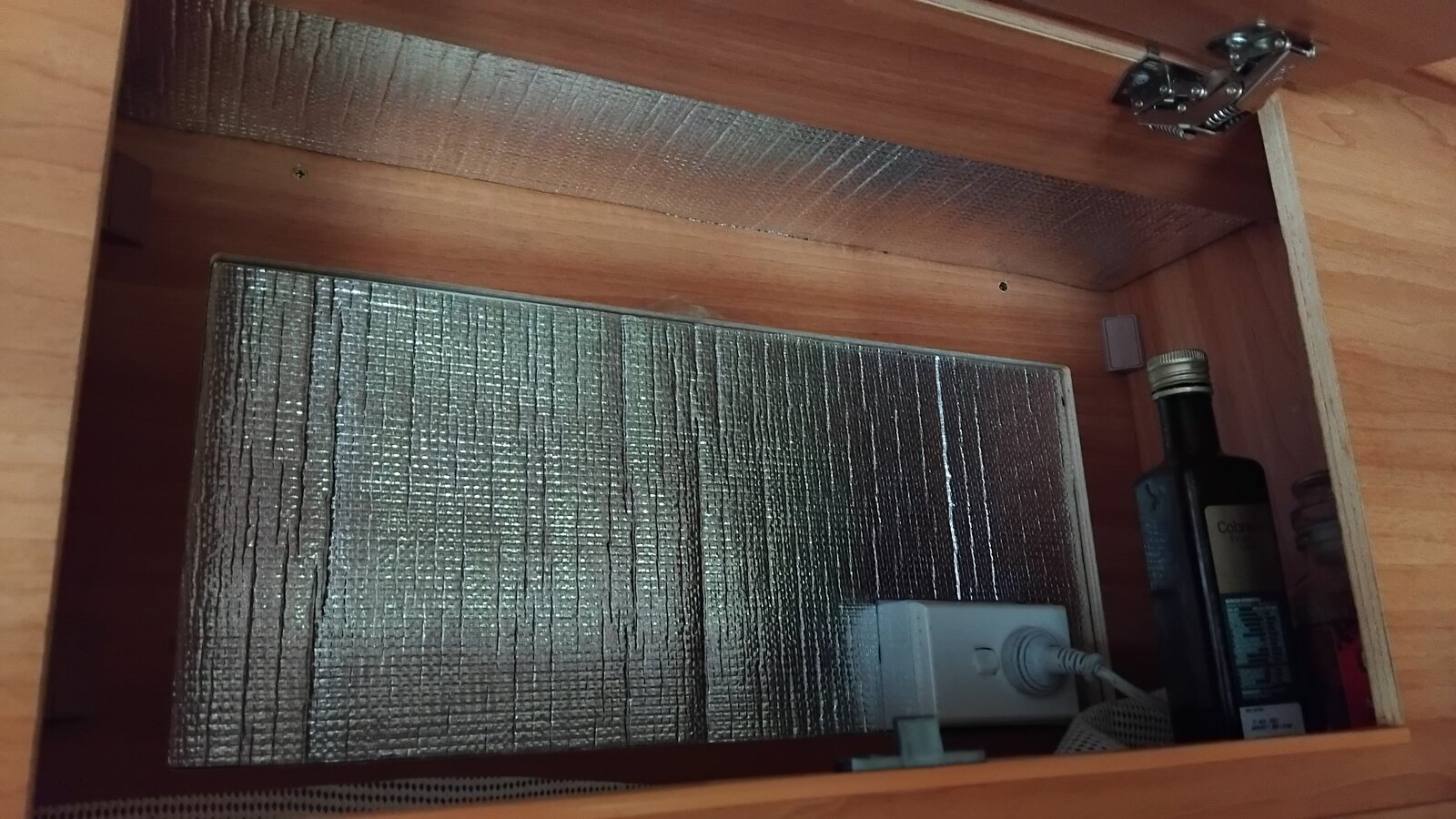

Something thats annoyed me for years and has been on The 'Round Tuit List for a number of years, on a nice sunny day the overhead cupboards tend to get very warm a times, especially the food storage ones including wardrobes ..................................
The other day I knocked another off the list, insulating the Garage Door, the morning sun turns it into a radiator, bluddy hot to touch, 8 years since I built this place and its been on the list since then, well No More, a roll of insulation has sorted it, 4mm foam stuff with allfoil outer layer of course some left over so I measured up the external hatches and the upper and wall sections of van cupboards, took a bit of jiggling but managed to use the roll with only about a 25mm strip left, very pleased, some bits that are mainly out of sight I cobbled together some off cuts to fit using packing tape on the back and then glued the sheet in place, the join is very hard to see ...................... The internal upper cupboards and wardrobes got insulation to the roof sections and the ones that have tucker in them got some on the outer walls, the battery box got lined as well as the door on the Genny Hatch along with the top section of the All Season roof vent .......... Surprise was for the garage and van done and I didn't make any monumental stuff ups .......
The stuff I used was from Bunnings, Ametalin 1350mm x 6.67mm Thermaliner at $84 a roll, the cross hatched side is stronger so thats the side to face outwards but it isn't terribly robust for hard knocks as the alfpoil could peel, its only a poofteenth thick............. it has a fire rating which is probably better than the van anyway and lining the battery box may keep things cooler and if the battery has a melt down then I doubt anything would contain the 600deg plus a battery gets to when it goes thermal ........... fire bricks and 15mm steel plate maybe...........
IMG_20250101_112312.jpg Battery Box.......... IMG_20250101_123909.jpg.. cupboard
.............. IMG_20241231_140839.jpg... Rule, tape measure, fine tip Nikko, Kwik Grip and large scissors .....
