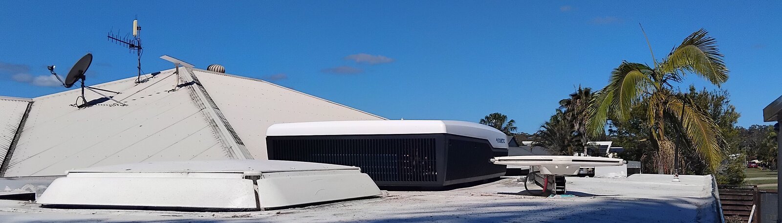

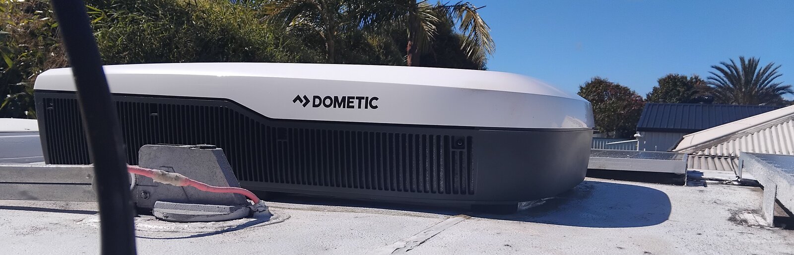

Okay Pay Day and I spent a good bit of it, the fellas turned up to fit the new AC in/on Big Mal, not really all that difficult but none of my mates here are limber enough to help, old farts all of them so paid someone to do it, something that doesn't come easy for me ... Must be getting old as I left the the old one where I would once keep it to dismantle, always some good bits, screws bolt, fittings etc .. Now its stuff it ....................................
It runs so quiet you have to check if its going, no window rattling, the interior lights are cool and it does have some nice functions, its not noisy so that wins me, Big Mal has had a B3000 in it, noisy shake the windows out affair then a Ibis Mk III, I thought it was fantastic, smooth operation, quiet but this FreshJet FJZ Pro is 3.4 cooling, and is so quiet the Sirocco on half throttle is noisier ...................... As for the WiFi/bluetooth bling, only interested in it for adjusting the power needs if running the LRPS off grid so we will see but I imagine the LRPS will have no dramas operating but may do a test run later just to see id=f any advantage to be had.... The remote stuff would be using precious data so I doubt it will be activated while off grid.
Since I was watching things unfold it came as no surprise to find a stuff up from the hail repair back in 2018, they cut the new roof panel before they fitted it, so much for experts, lay the new skin then do the cutouts of course, they did a good bog job as it has never leaked and I put these fitters on notice though, to which they asured me would be all good and they know if it leaks it won't bode well ............................. I even lent them some gear for the job and they will be making the same next week as it made their job so much easier ... and I got a discount ....
Good chance I'll give it a genny run in a few days unless I put the gennies fuel in the mower .................. might even plug the meter in to see..
All in all a tidy unit, lighter than the Ibis MkIII and I have no problems recomending www.caravanrvcamping.com.au as a supplier for this stuff, they have supplied my Fridge and now this AC and both times I have saved quite a few hundred $$, fast freight direct from Dometic in Brissie actually and hundreds of $$ cheaper than the manufacturers web site or other places ..

Well @jazzeddie1234 , prefect day, warm and muggy, so the LRPS was fired up to test out the new AC .............
Fired up the Red 2kva on normal throttle, didn't notice any change in revs on genny and had to put hand over AC air outlet to see if AC had started, AC was set at unlimited amps, put Genny in Eco Mode no changes in revs even with fan adjustments, put AC into 7 amp power draw fans kept going at full so all in all its a bluddy marvelous bit of gear, the Honda didn't really notice it was there ...................... if I had water connected I would have given the washing machine a run as well to see how the genny handled it and the AC, you can tell the washing machine is running as the genny revs fluctuate if in Eco mode ....................... I suppose I should have put a meter on the power board to see how much but going by ear was easier ....
The AC is so quiet you don't know its running at all, the old Ibis Mk III would growl away with the odd soft thump and the genny would do a rev dance when it fired up.
I doubt I will need the power adjustment which allows you to set it to Unlimited or 7a-5a- 4 amp, it will be very handy for some showgrounds that only have 10 amp sockets, maybe 7a for genny run in Eco to save the ears and fuel ..................
