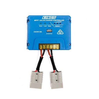

Good point Mike @mikerezny. Friend I wrote about earlier saw a Kings 250w folding solar blanket advertised at $220.00 which was supposed to have a MPPT controller attached. Warned him about possible false advertising, so he rang the 4WD company selling this product to check. They told him that it did have a MPPT controller included for that price. When he bought it, he was bypassing the controller anyway as he was set up with lithium battery/ies. I checked up on Ebay and see that Kings are indeed advertising MPPT solar controllers (20A I think) for less than $80.00. Did not get a chance to look at friend's controller and open it up to see if it has a large (or any sort of) inductor. Don't think it had any/many settings or controls, no screen, just LEDs indication. Is it possible that they have come down so much in price????
