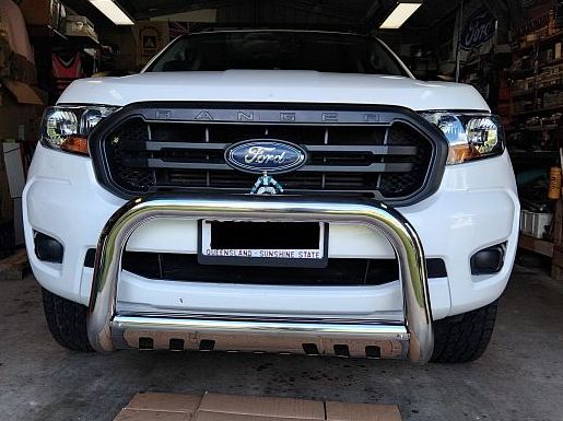

The bracket is in the mail, well I have a tracking number but nothing else, so yesterday arvo I fit what I can and trim the skirt to get ready, well I get a good look at what the missing bracket will look like, a bit of bench work, 20 mins later I have a bracket made, so finish the whole thing.. When the proper one turns up I'll check which one is best but for now I'm happy.. The Ranger is set up, for now, something else is bound to get me inspired but later on ....
Went a nudge bar to scare off the Bump Park idiots at Woolies, place crawling with doderers, a nice ECB bull bar is just a lot of $$$$, don't do night or sunrise driving so Skippy not a problem and locally its horses so a bull bar make no difference .........
IMG_20251203_161456.jpg............... PS: not crooked, I wasn't square on when I took the pic.. I checked as a bit OCD with that stuff...

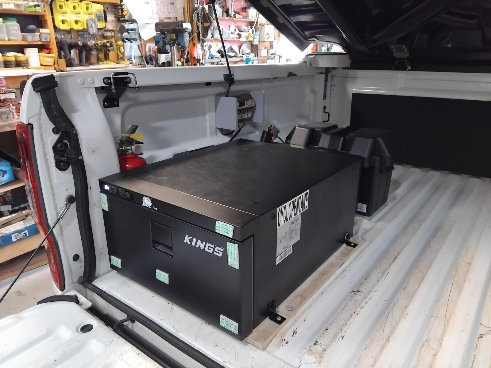

Well the 3800km test run completed, nice fuel economy, ran well though I will need to upgrade the rear springs in due course ............. While in Canberra we did some Boxing Day special shopping at Kings, 110w fixed panel $49, 30lt drawer fridge $200 ?, gave it a mock up test and went really well and now that I'm home and its all fitted properly, used my old GEL battery from van that was okay and coupled with the ProStar controller with the panel on the roof racks its working way better than I expected ..... turn it on and in about 30 mins its down to 3c, even quicker if the panel is in the sun, once its at temp I can leave it in garage running all night and power draw is bugga all, so Im very happy.................. Its main job is for transporting stuff from ALDI 60kms away when we go for a restock instead of chilly bags with ice blocks..
Son had a 100a slim lithium and in a moment of stupidity I said Nah, I haven't got anything to charge it, what a numbskul, I should have just bought a Dc/DC or something, lifting the damn GEL onto the tail gate near killed me then I had to lift it up under the hard lid into it's box.... Stupid old person.....

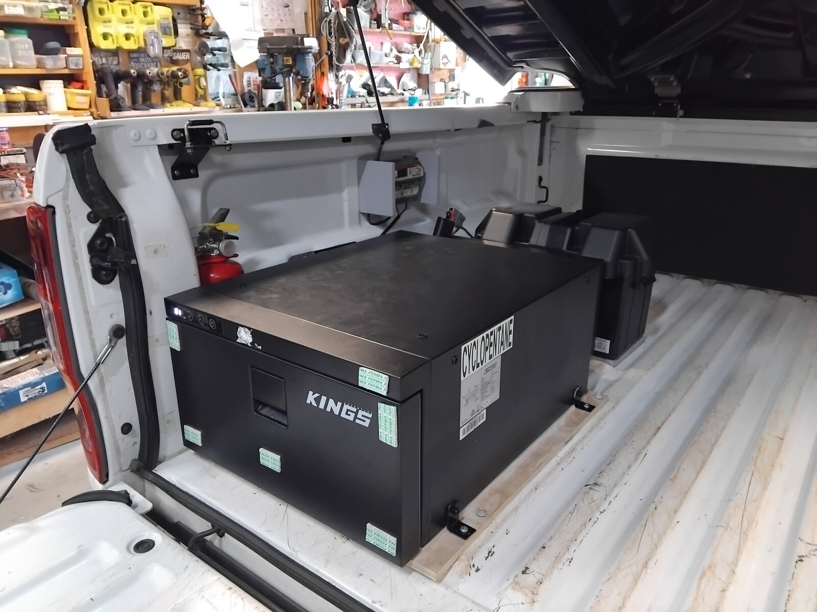

The new fridge in back works a treat but the old GEL battery can struggle after a few days in shed without charge to fire up the fridge in morning unless I park in driveway when I turn it on to get some help from Sol ..................

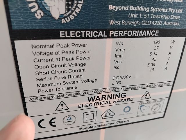

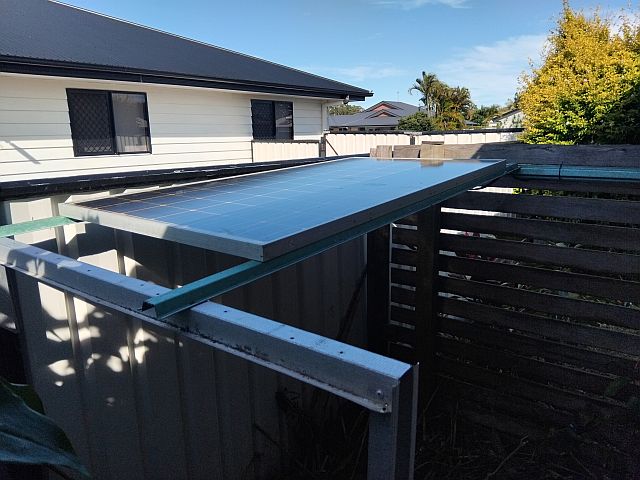

I could have just used my 5 amp Ctek mains charger but it means it has to plugged in and mounted near the power point, it does have an anderson plug though my idea was dig around in shed and pull out one of the old house panels I got awhile back, then its just unplug Ute panel and plug in house panel, 190w 36v or something, the reg in Henry is the old PWM from van which is a great bit pf gear and it will take up to 90v or some such unlike most which will have a 24 or maybe 36v, side of my garage gets sun most of day so could see no sense in being an old fart on a ladder so knocked up a frame and slung the panel beside the fence, it works far better than expected, pic shows it in shadow at 1559, its still pushing out 2.2a of charge, very surprised.... I ran the battery down earlier to see how things went ... Now a big Day Glow flag to hang from lead so I see it and unplug before I drive off ..................... its bound to happen...
Funny that a 190w 36v panel shunts 5.4a while my 100w Kings panel will push about the same @18v ...................

It's all about WATTS Ian. 5.4 amps at 36 volts amounts to approx 194 watts, while 5.4 amps at 18 volts amounts to only half the total output of approx 97 watts. That really shows how much a proper MPPT controller can make use of that higher voltage compared to a PWM controller.....if you use a MPPT controller!!! 194 watts can be converted to approx 10 amps at 18 volts or better still over 13 AMPS at 14 volts which is a good charging voltage. Disregarding any losses in both cases. Have you got an old MPPT controller?

Using the old ProStar unit which is certainly better than some of the cheapy MPPT controllers, early days to really see how well this set up works but I had it on the shed panel and it did push out good power, in both cases its basically just keeping the battery topped up so is perfect for the job ... Cost so far has been nil as reusing cable and andersons ........................
The Epever in van does show the advantage of a MPPT as it will push some nice power at 15v , certainly good early morning and late evening .... looking forward to later today to see how it goes with full sun on it was pushing .4 at 0630 so signs good.
I have an old TPM 1230 unit as well but I fear it would fry if I plugged in a house panel, need to scrounge another controller for the shed now, something that will handle up to 48v at least, time to wander the garage sales I suppose.....................
Side fence runs practically East/West didn't want to climb on roof thankfully, why tempt fate.
