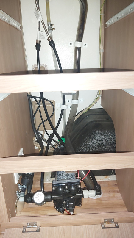

Shurflo water pump installed... Just have to wire it up.

I leave the mains going to the hot side of the mixer tap.
I put a T piece in the hand pump line and connected the pump. I put a tap between the hand pump and T piece to isolate the hand pump. I realise there is a non return valve below the hand pump already but in my experience with the previous van, the pump could suck air back through that tap and valve, so a permanent tap installed in the line fixed that. It never gets used but I leave the hand pump there just in case the battery fails or pump fails.
The pump outlet I run up to the cold side of the mixer.
I fill my tank from the house, with filtered water (underbench filter system). Yes, that takes a while at roughly 2L/min but I just set a timer and leave it. Check it about 35-40min later.
So if we have a water hook up, it's tank water for drinking, cooking etc and mains for washing.
To wire it in, I'll probably put a gauge with an isolation switch just inside the door on the end of that cupboard. You can see factory wiring at the back of the under sink cupboard in the pic. I'll follow that through. To get to the battery I'm going through the floor and under the van and back up in to the battery area. I have conduit but unsure of exactly what I'll do going through the floor, whether to use just a rubber grommet or a cable gland.
Hopefully by the end of today it will be functioning.
13,195
19,992
Looks nicely done and sounds like it should work okay, the water lines to and from pump I would run a bit of insulation over them where they touch things as a good chance they will transmit the pump noise....
The only concern I have is the power point in that position, its not safe at all, shouldn't be in the same enclosure as the water lines, even moving the point higher up its not safe , I would relocate it to an adjoining cupboard away from the danger.

Power point there is factory. I realise there is some risk if there is a leak but I think it's a small risk. Maybe I'll add a piece of something under the switch, covering the pipes just in case.

I dont think the power point is an issue. Plumbers and electricians have been sharing cupboard space for ever, I can think of mult occurances in the home, the kitchen sink cupboard is the best example with the power point for dishwashers and dishwasher connection and drain hoses, water filters connected with John Guest fittings and braided hoses that will fail within 5- 10 years all sharing the same space. The spa bath pump is another example.
True, have never been keen on that point under the sink in house but then only rarely seen the cupboard awash, though in vans a bit more often from joins letting go................. yet they have rules for bathrooms and laundries regarding power points....

Install is complete. I went under the van with the wiring through some 25mm conduit mounted behind a cross member. Bit hard to see in the pic, but you get the idea. I found some cable glands that although weren't long enough to go right through the floor, they did thread into the floor (13mm hole) so they are nice and tight.
Once all the drawers were back in etc the noise was a non issue. Not quite sure why some people complain about the noise. Certainly not an issue for my ears.
