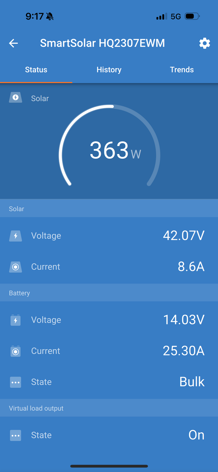

Hi Mate
Last year I fitted a Victron Smart 50amp MPPT and made the BM pro redundant for any charging purposes . Just before easter I ditched the original panels and fitted 4 x 200 watt high voltage sphere panels in series, as the run through the roof was long in 6mm auto wire. Results so far are very impressive.
Just love the Victron stuff, it works so well. The app is the best I've come across and just works. The separate's give you redundancies, about the only criticism is its size and lack of IP rating.

Hi Mate
