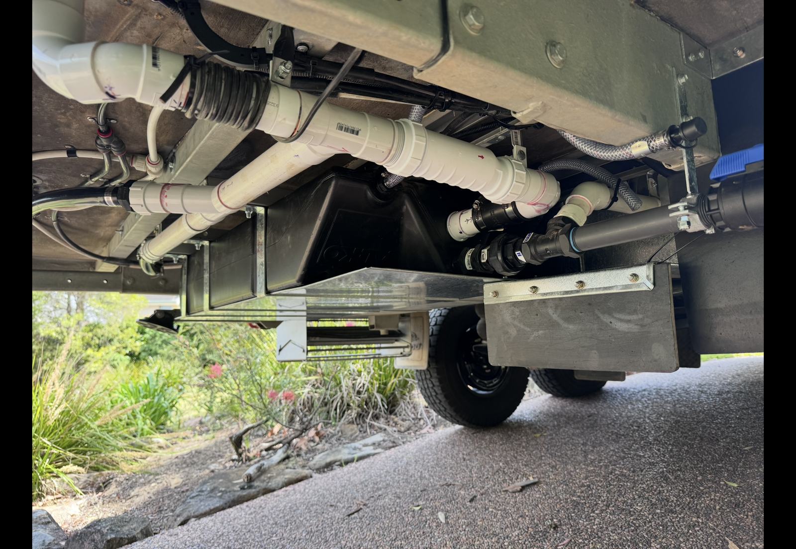

Can’t work out Jaycos third tank plumbing . Not sure the pic is clear enough .
They have balanced the two front tanks with the pick up line . Was getting air in the line when using front two and they are not drawing down evenly. Would have thought you’d balance at the bottom ?
Anyway plan is to isolate front tank and fit seperate pump and filter (again) and have as a dedicated drinking only ! The adventurers are Plumbed like this and @Crusty181 gave me the idea when he mentioned his love of melbourne water :D

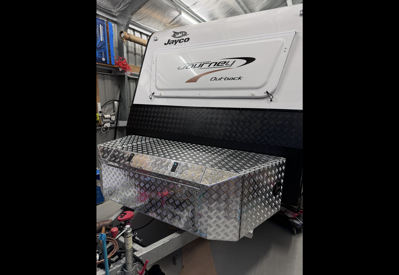

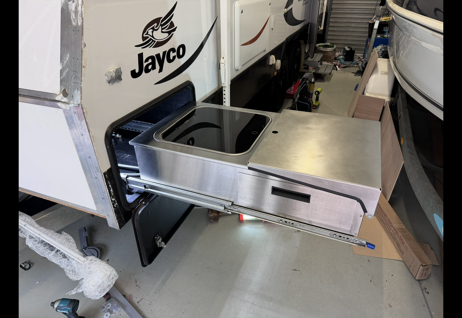

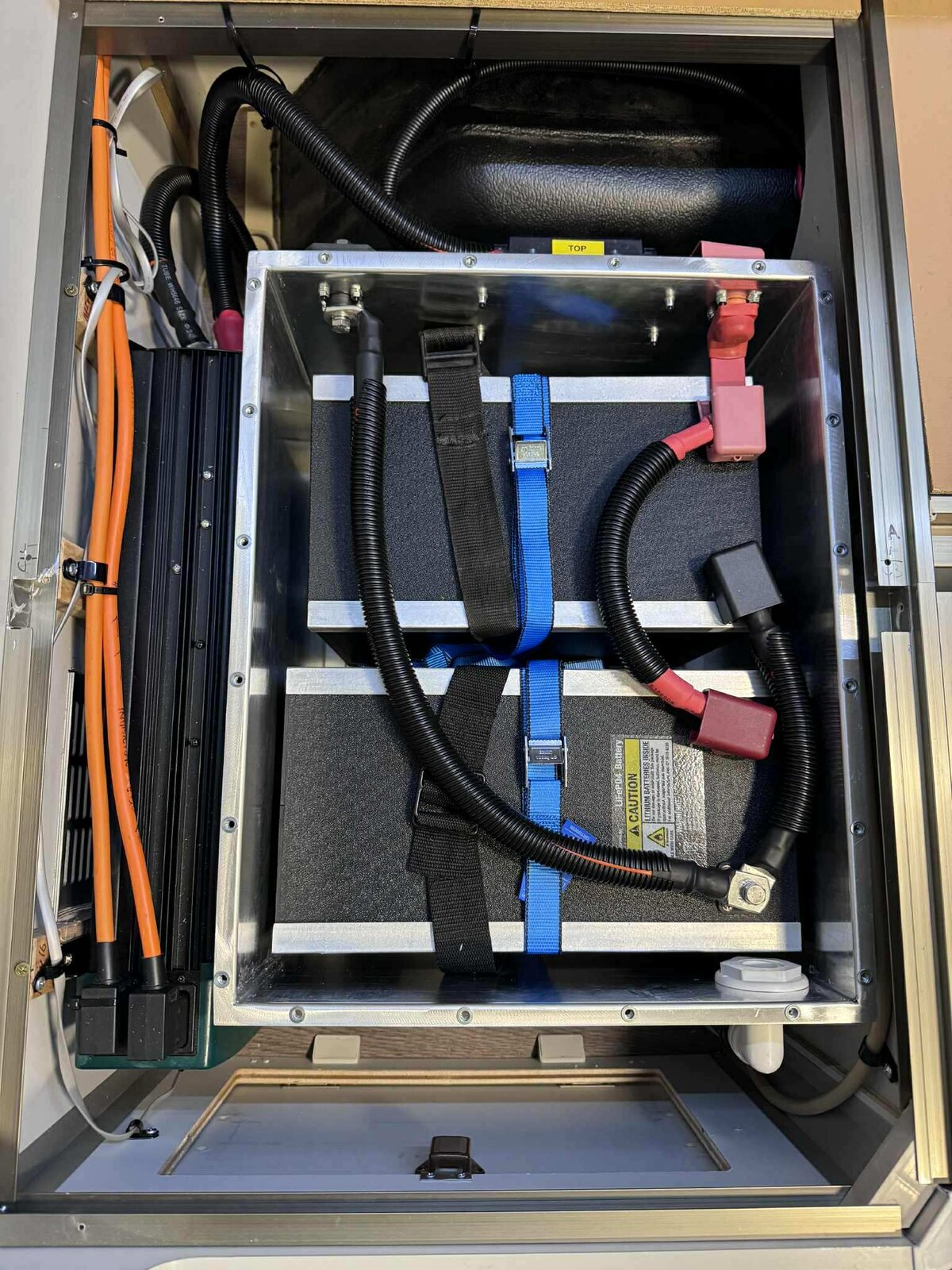

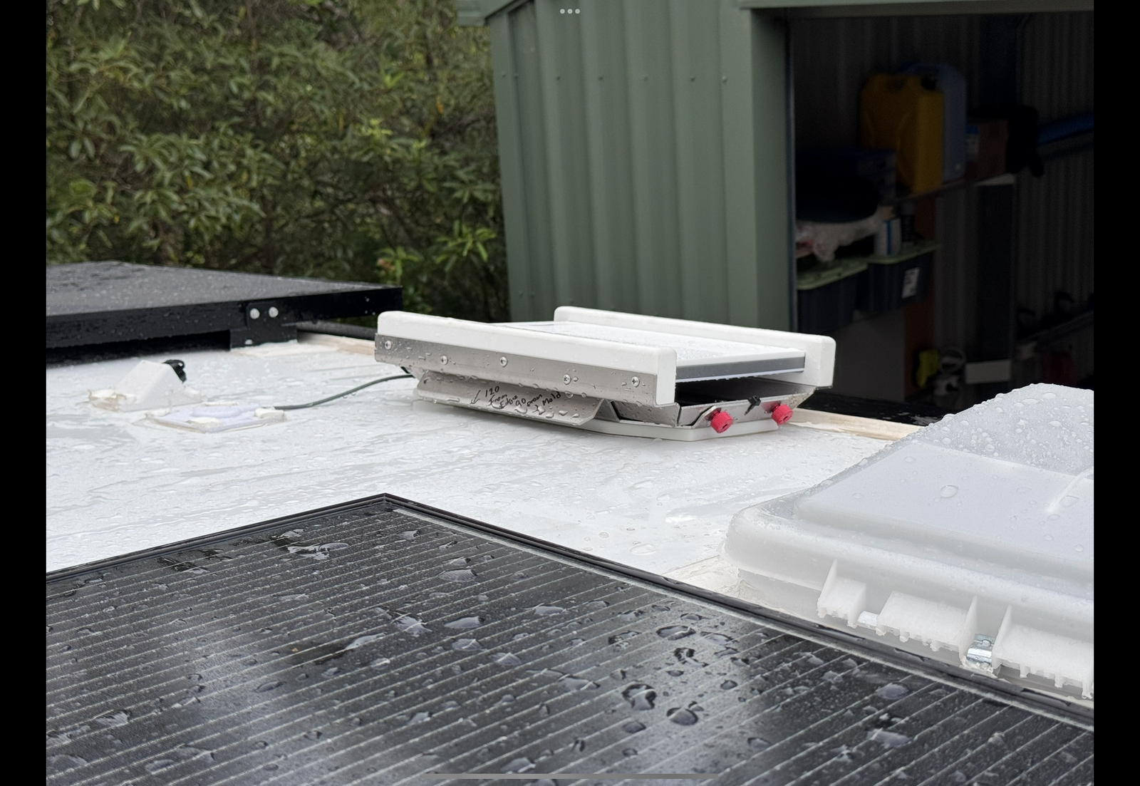

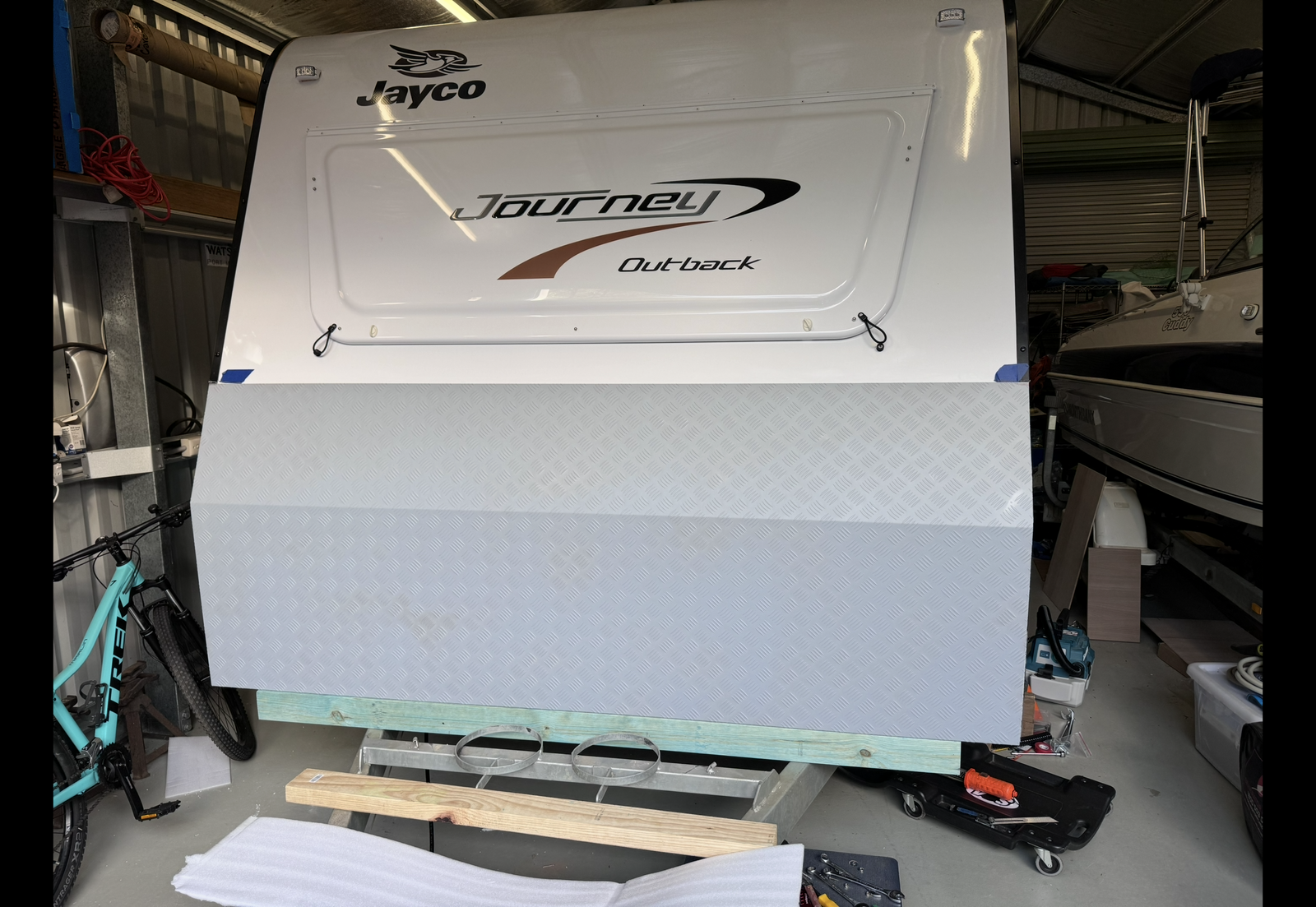

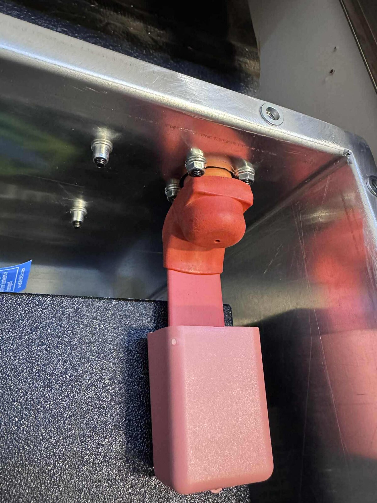

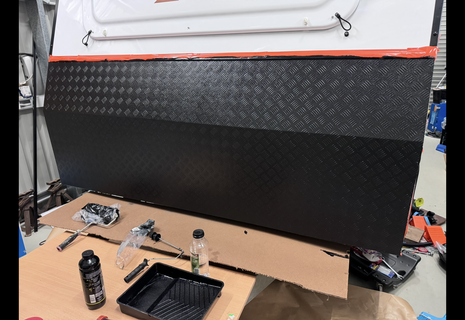

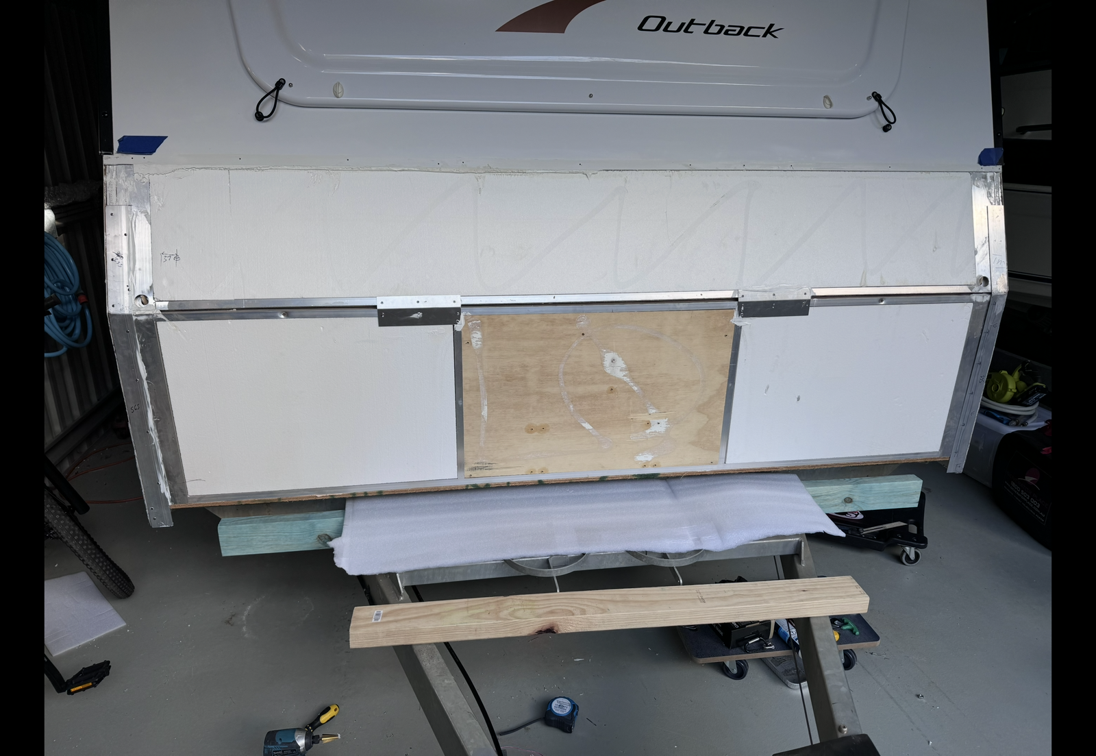

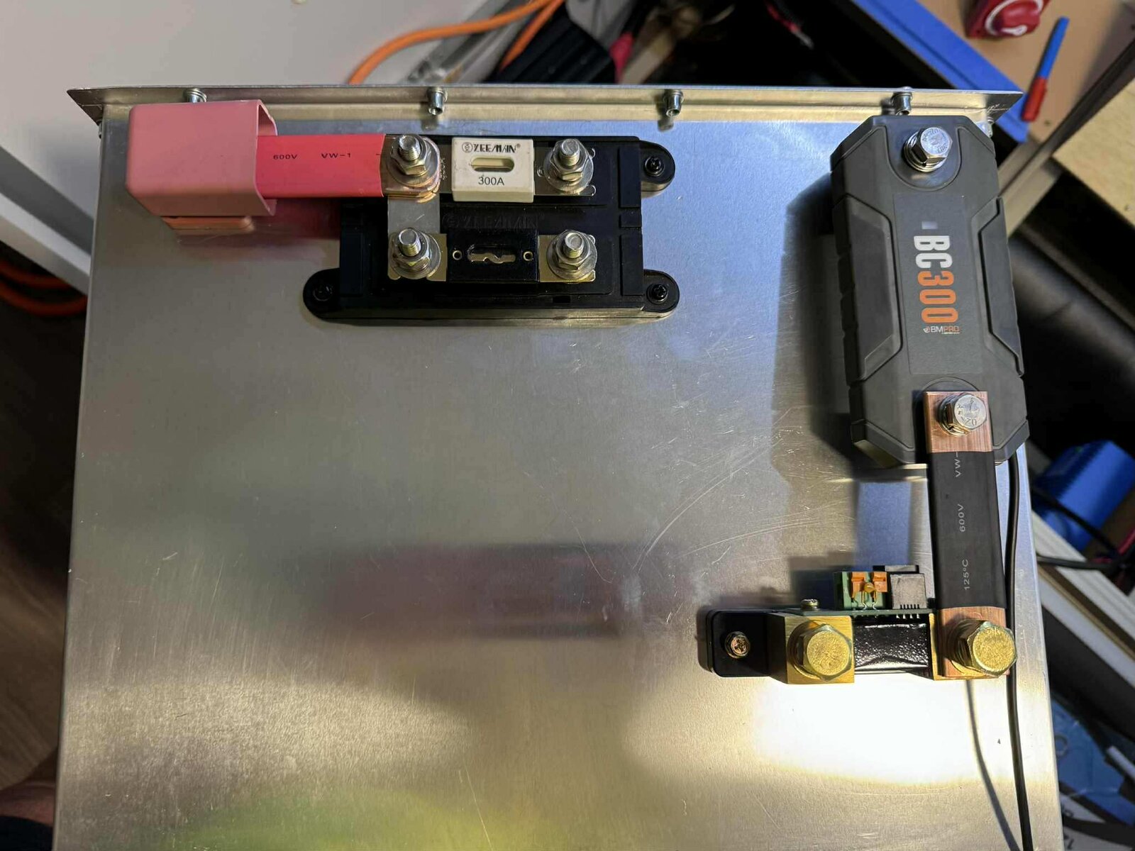

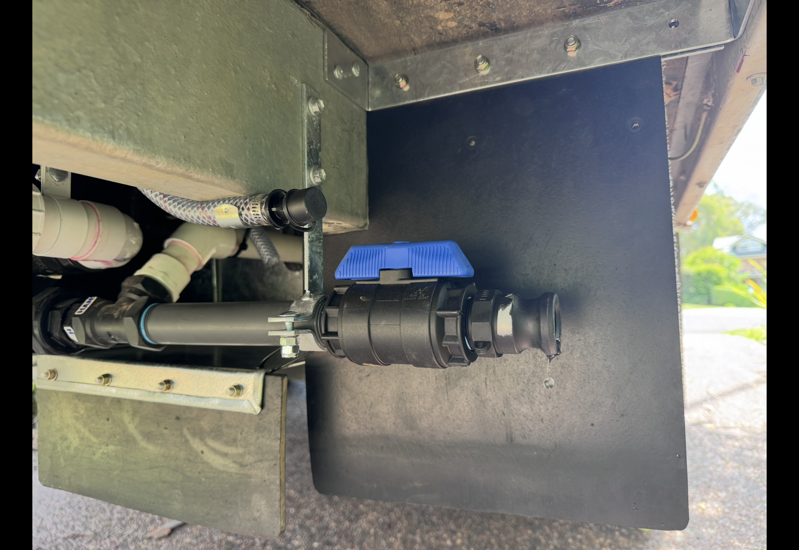

Still got the van , had a few family things to sort out with elderly folks but it’s now clocked about 30,000 Kms.
added slide out kitchen .
Removed old front and added a front box with LpG Weber and second dunny cart.
560AH of lithium and a enerdrive 2600w auto switching inverter.
800w sphere high voltage panels with Victron gear
65litre grey water tank and replumbed the laundry through it so besides the washing machine flushing the tank acts as a buffer and only need to use the one 25mm sullage hose.

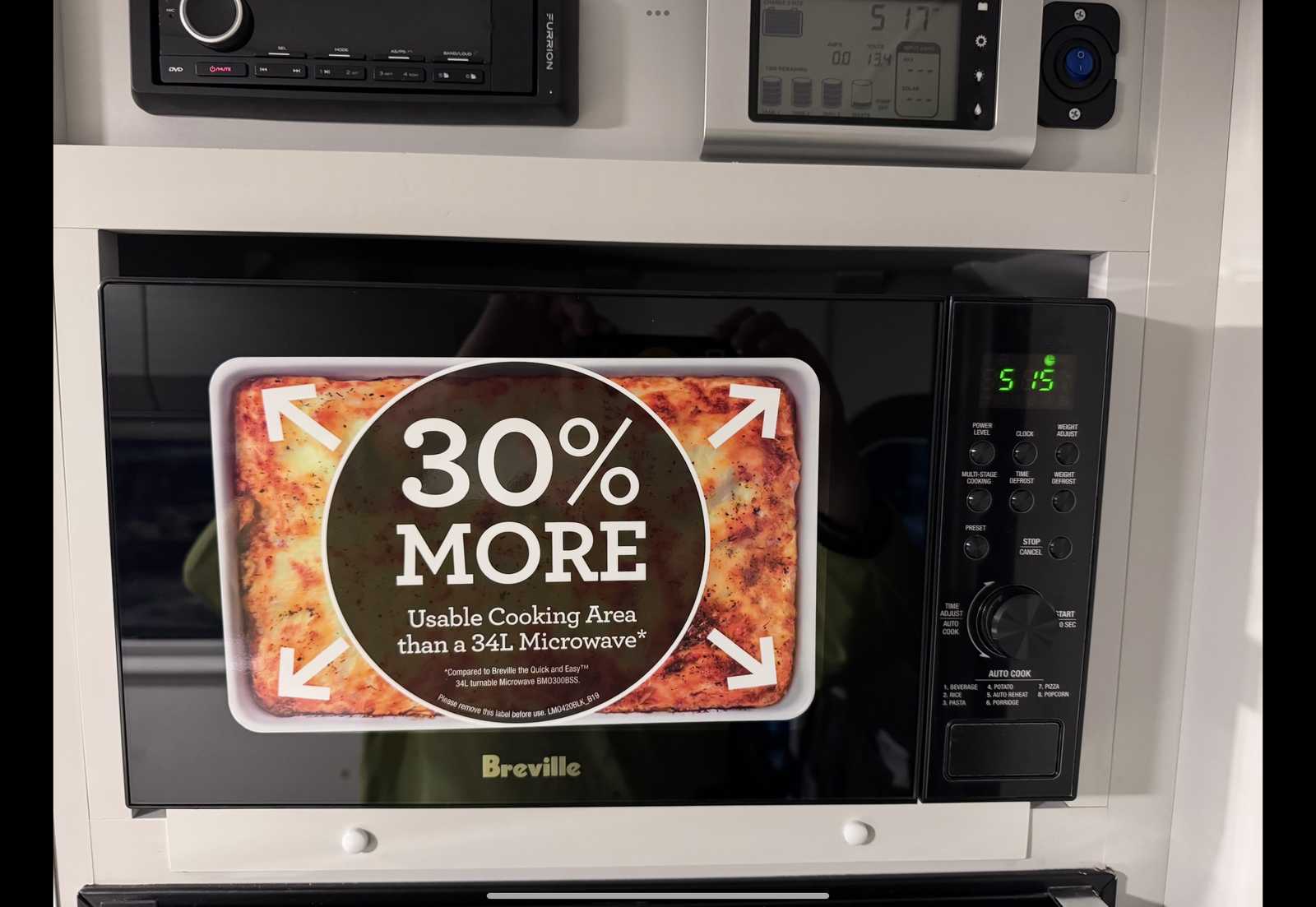

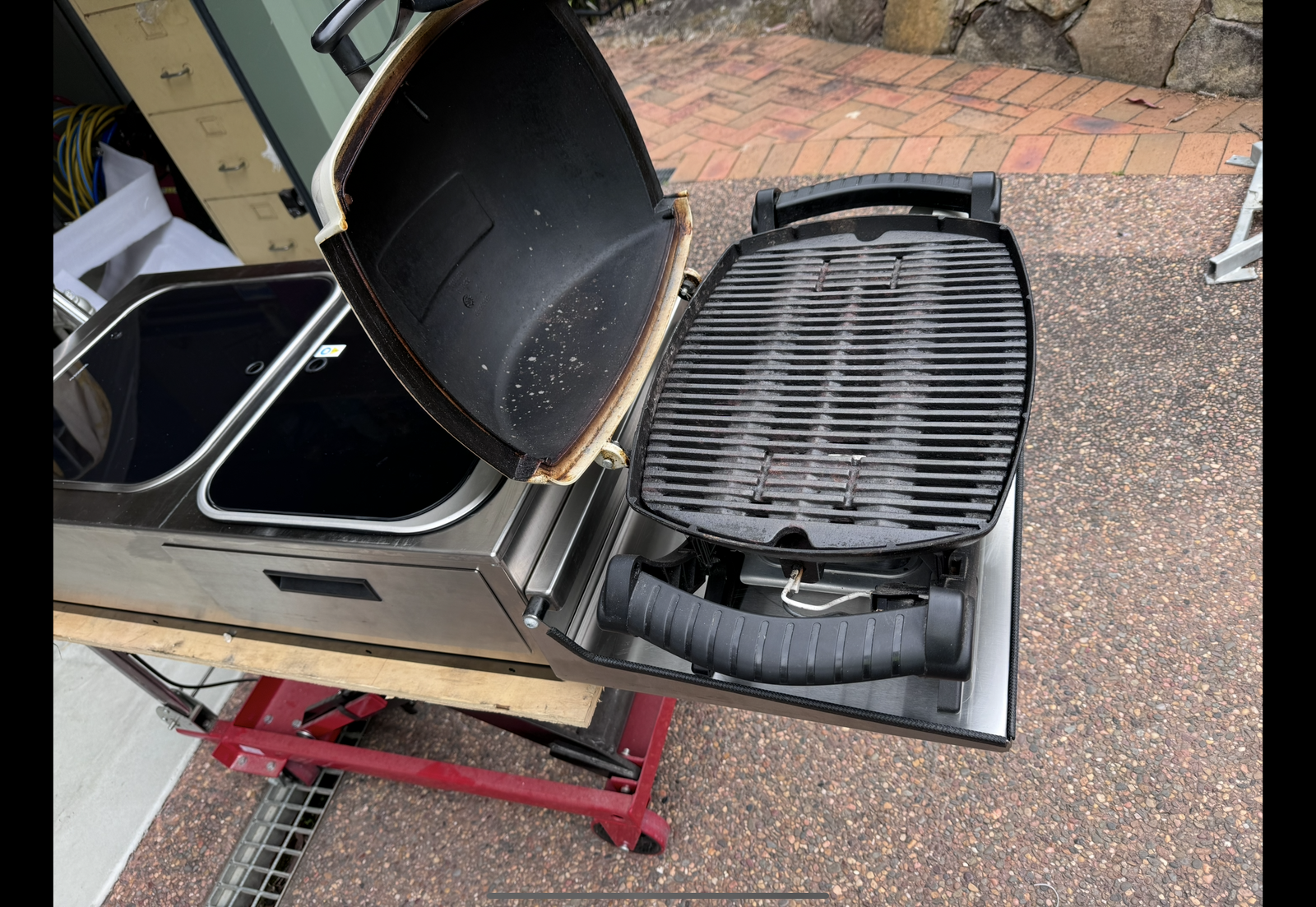

Flat bed microwave ( and mounted it properly ) no more taking plate out !
starlink mini and the grey tank with “ flushing “ port as well.
