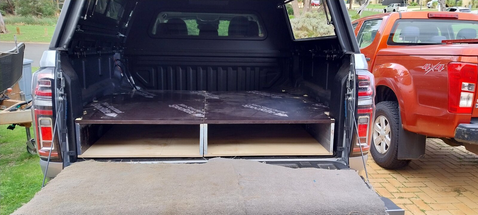

I can't put it off any longer. The old diy layout for the Dmax fitted ok but I need to change things around because the Cannon does not have a long range tank - which means jerries, and jerries need to be easy to fill, which means moving the fridge, and the fridge needs to easy to fill, which means moving the toolbox....sigh. Also the back seat area is a different shape and we now have a dog.
20260602_153536.jpg First test fit. I cut a cardboard template and then off to bunnings to buy some 17mm formply and 12mm basic plywood. My ladder and chairs used to lay on top of everything but will now slide under. I first made it in one piece but it was way to heavy for me to lift and cutting it in half makes it much easier to get in.

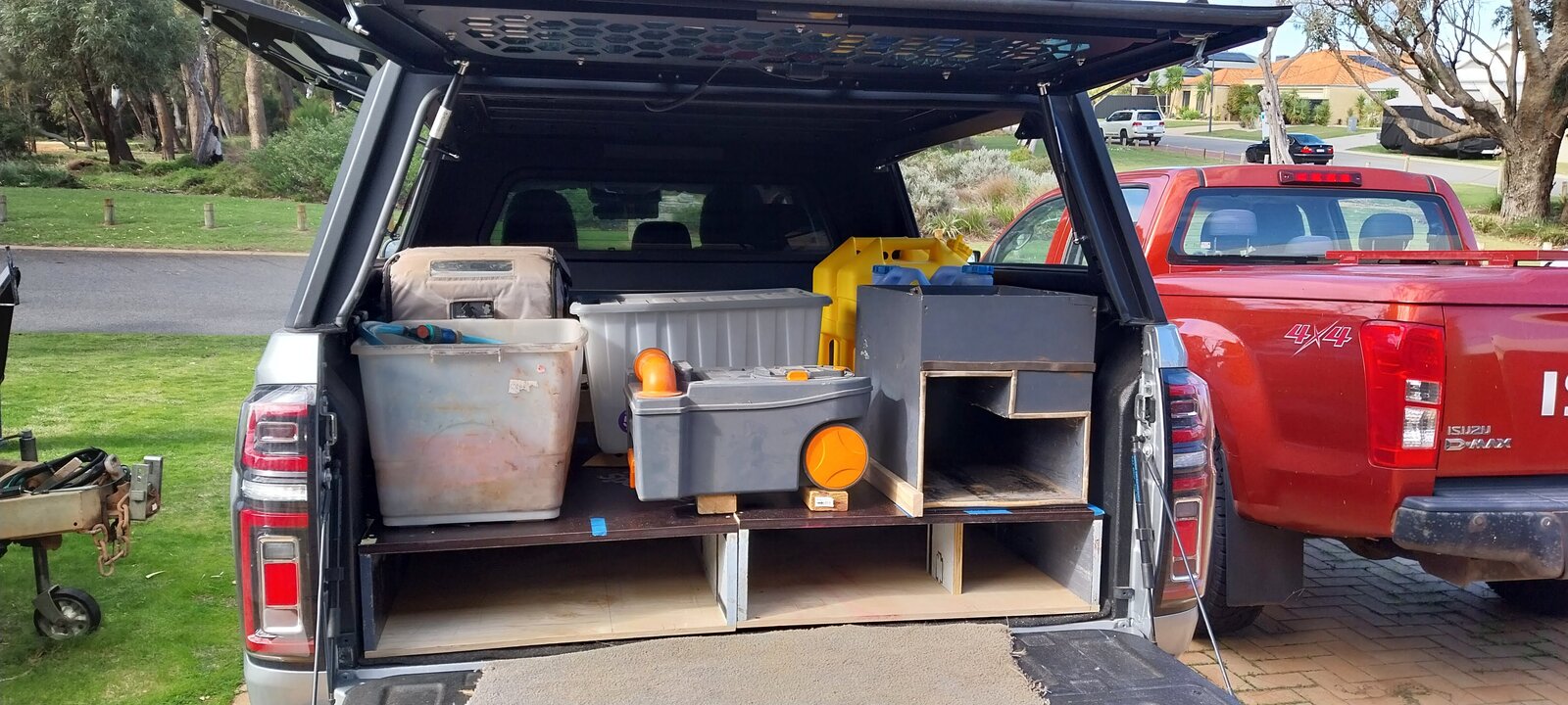

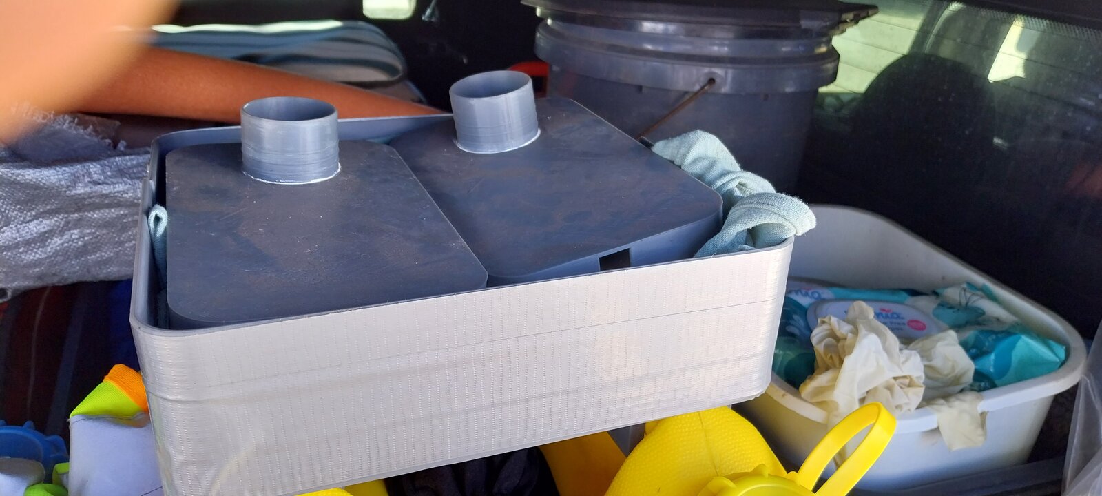

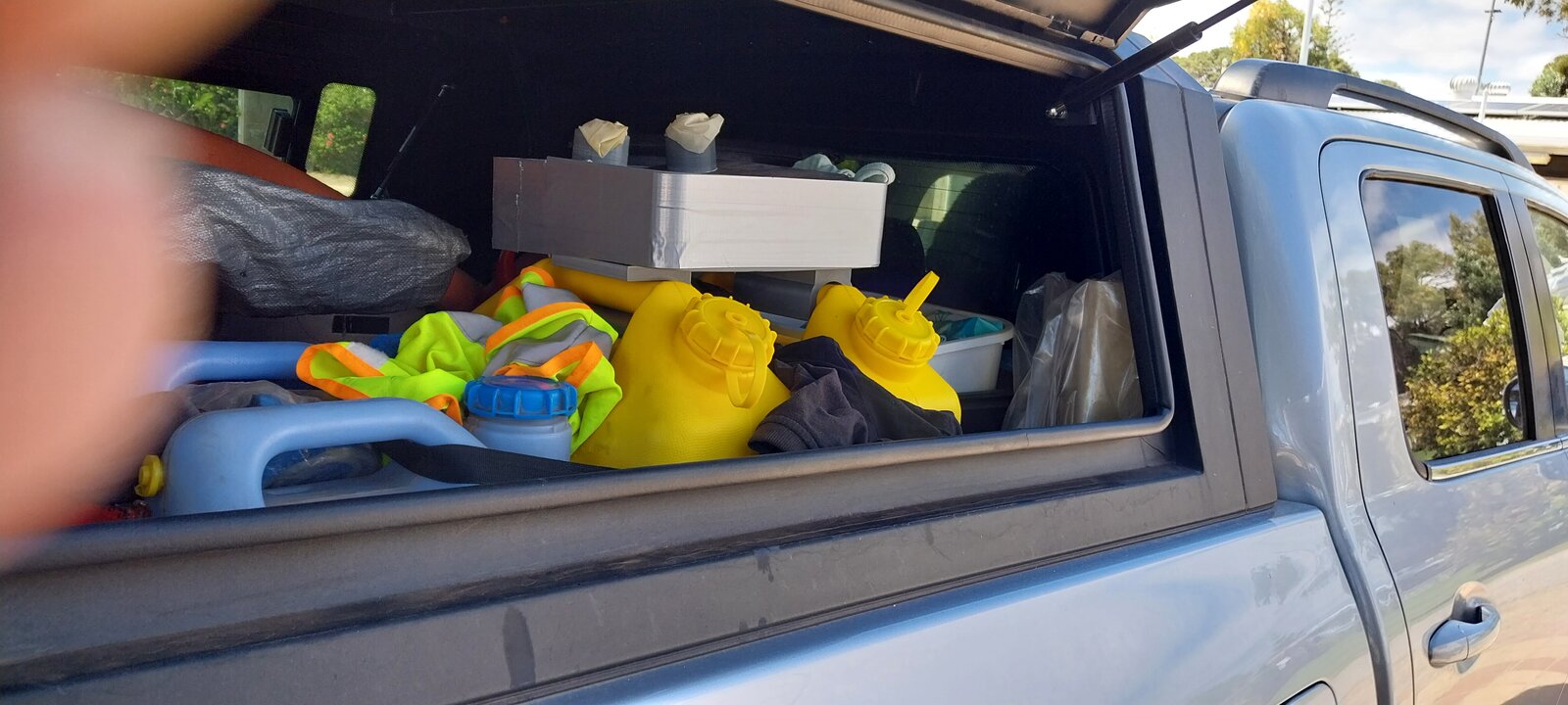

20260603_110214.jpgSo far so good. Jerries are easy to access - I'm hoping no one notices me filling them as they are right next to the filler door and I've 3d printed a drip tray that fits in the necks so any spills with run outside the open window. The fridge is fine on the other side - easy to access via the other window. The honda generator is rarely used these days so it will slide all the way back between to fridge and the jerries and sitt over the strong centre supports.
Next job is make custom shape boxes for the jerries etc and figure out how to stop things moving around but easy to slide out if necessary

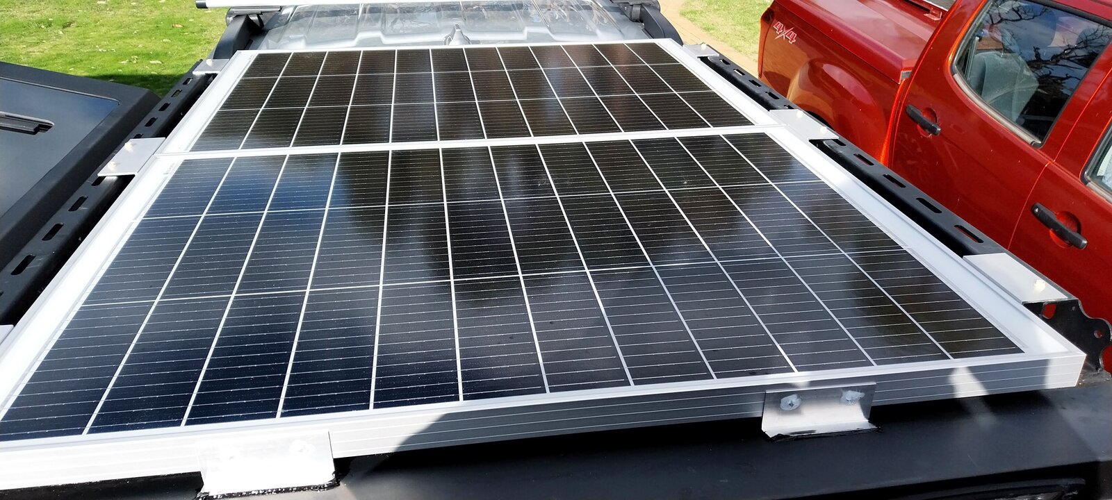

Finally fitted the solar onto the canopy after a week of wet days. Shakedown trip next week so a bit of a push to get stuff finalised before the bigger trip to Broome or wherever we end up. I chose the panels purely on dimensions so they sit inside the roof rails
very neat,well thought out, do you want to put a canoe on top?

Haha no but I do need to transport some long lengths of skirting and I wanted to keep the overall ute height down. Now I can fit a simple cross bar/roof rack when needed on occasion
