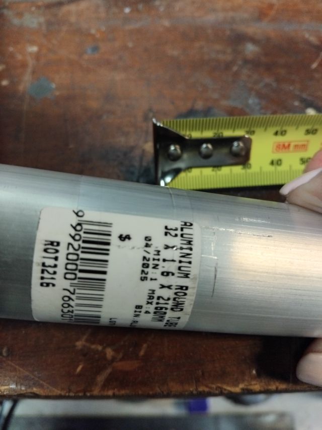

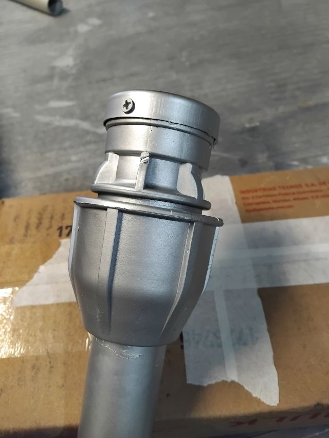

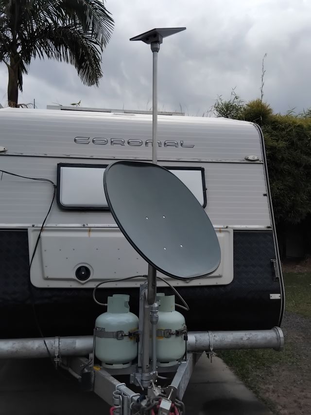

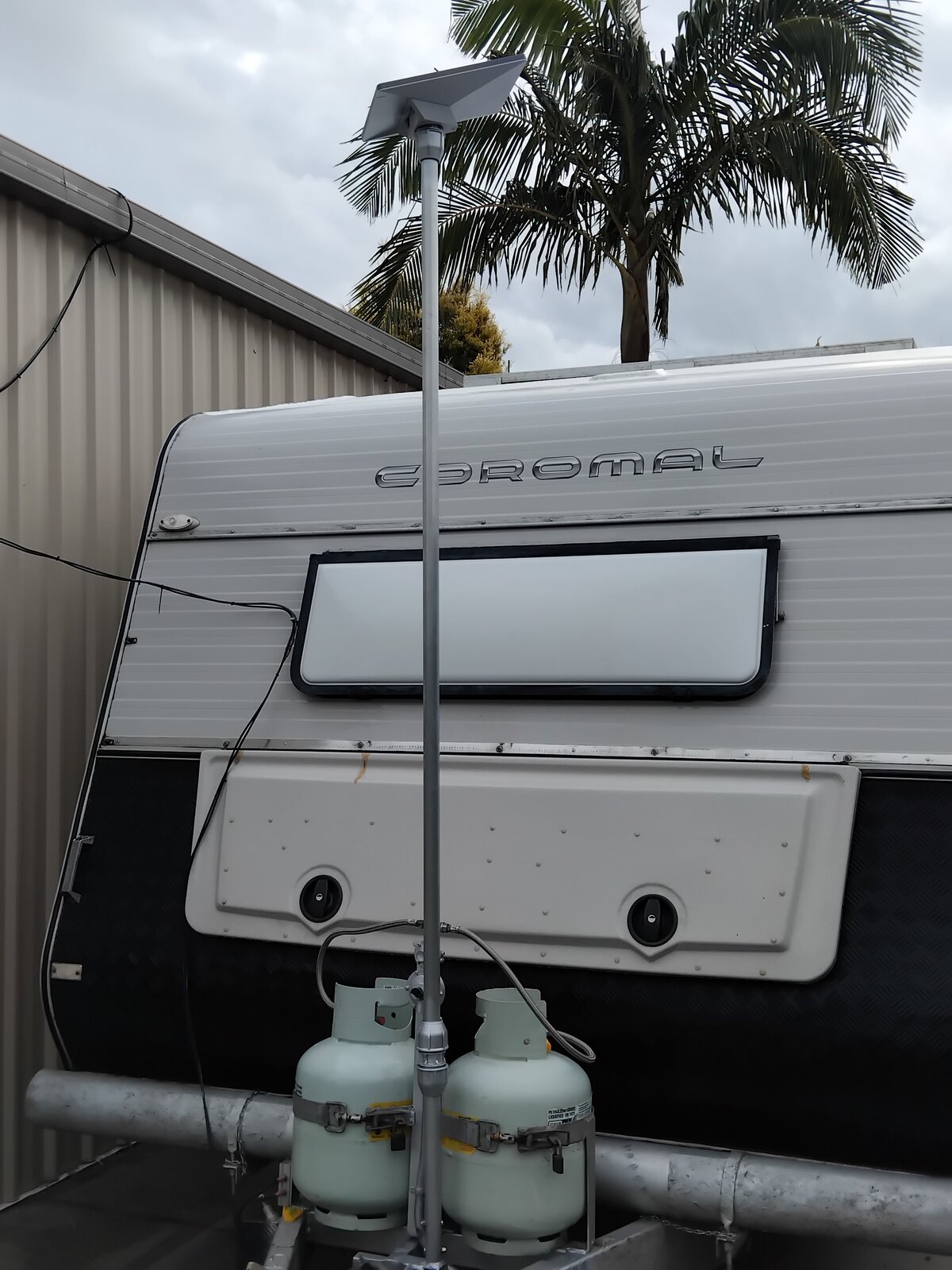

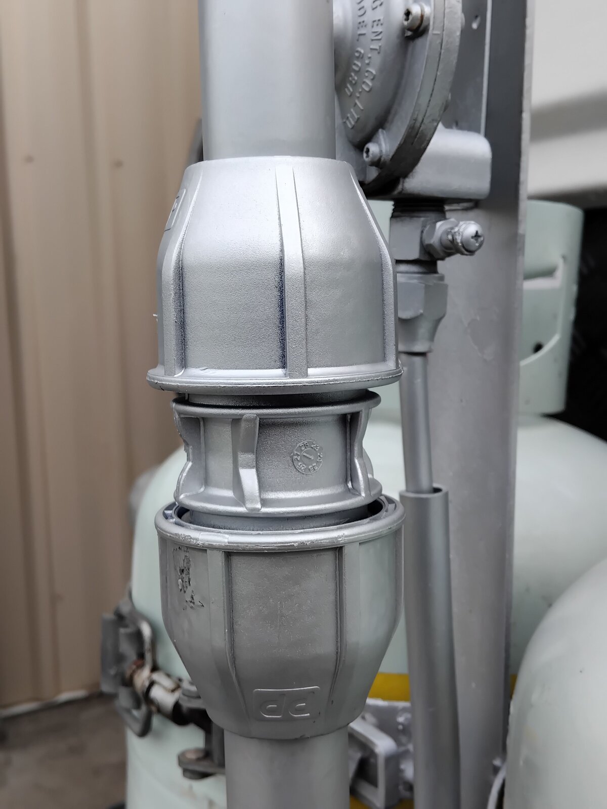

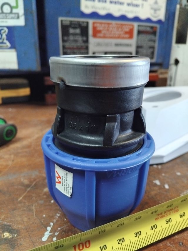

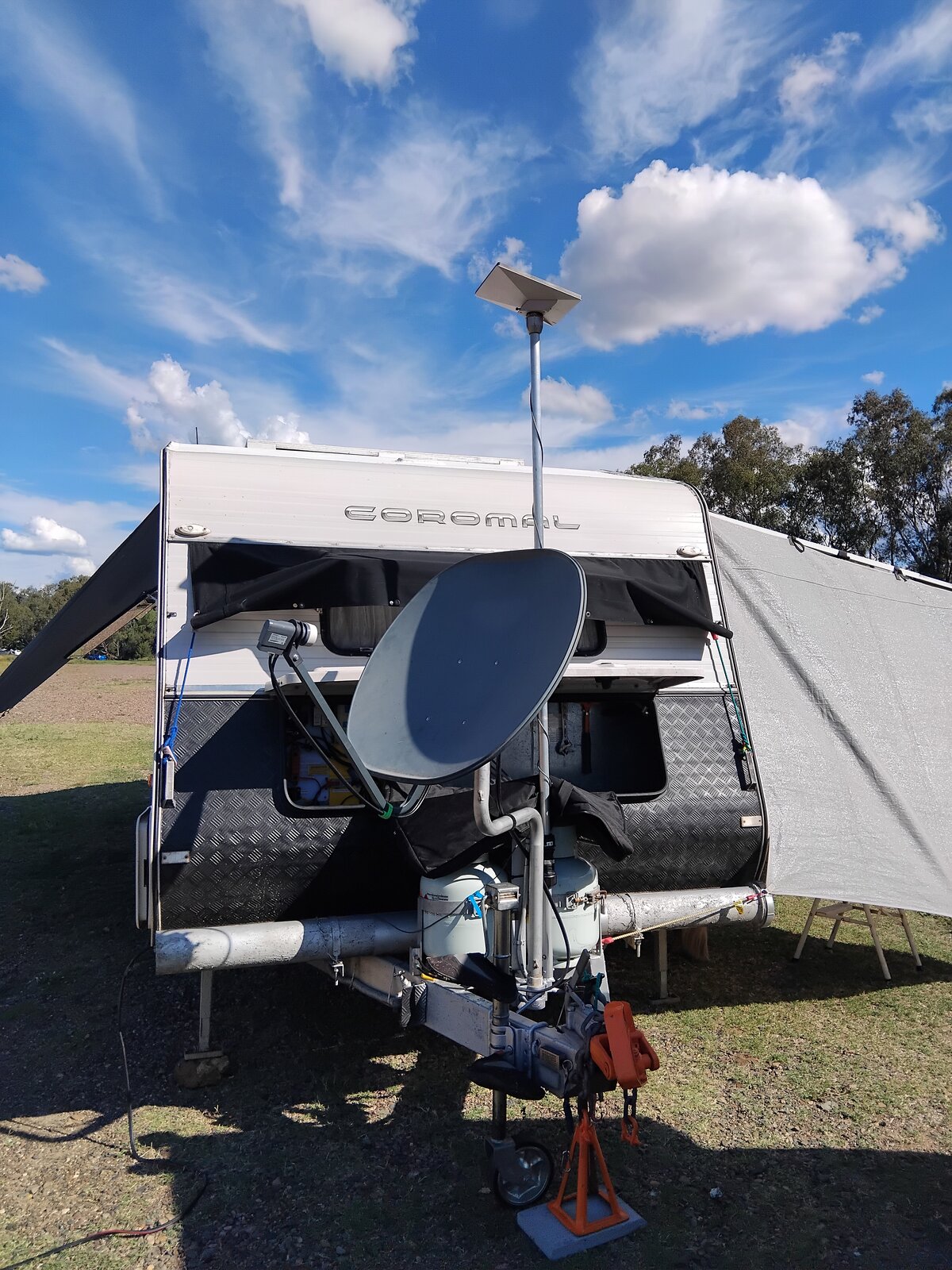

Over the last few weeks the grand plan has been unfolding to have a set up built on the KiSS principle, so no stuffiing around, first off a stand /pole for it, no way I was going to spend $300 for a shop bought pole, I rumaged in my shed and found some alloy tube off cuts, and a irrigation coupling to experiment with, in the end a trip to Mitre 10 for a length of 32mm tube, 1 x 32mm joiner and a 32mm 1" female adapter, it has a stainless steel ring which is ideal for locking the dishy onto...
. 32mm tube.jpg..32mm alloy tube...................32mm1inchcoupling.jpg......32mm-1" female ...................................end coupling.jpg ........... mounted ..
Mail delivered a 12/30v convertor,3.6amp, again the Starlink shops want $150 or even more, I bought mine from a supplier I have used often over the years for aerial parts and bits, $44, this is hard wired into my vans 12v Media circuit which I set up to power the TV/VAST/Foxtel as the Foxbox was having supply problems so a dedicated circuit fitted direct from the load Buss and is switchable from inside the van so I can power it down, the Starlink plugs into it via an Anderson plug on van side, I wasn't keen on the dicky 5.5/2.1 sockets, no power drop at all, if there is my meters don't see it and finally a bracket and fitting welded to Sat Dish bracket for the mast to slip onto with the 32mm joiner which once Starlink is pointed south can be locked in position, it can also be fitted to the rear Sat dish mount on the rear if needed or sat on the ground away from the van..... Time will tell but if I park with a clear North/South view all should be good ............. Sat dish needs due North and Starlink needs due South, though I can aim over trees with the Sat dish, Starlink need a bigger clear view......
Finished.jpg pole ........................joiner adjuster.jpg..... pole direction adjuster ...................TaaDaah.jpg ... with sat dish,..

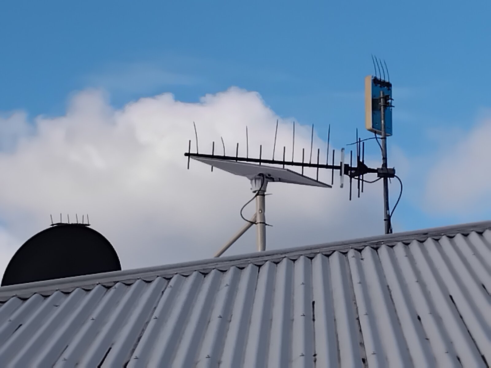

We now have a Starlink Standard 4X on the roof , well been up there since March, not long after my last post they dropped the congestion fee so I ordered one, $19 postage, free rental and $69/mth for unlimited download at 100mbps, took a week to get here and had it all set up and running in an hour ... I had an old Foxtel sat dish roof mount in shed so that got refurbished and mounted up with the aerial farm on my roof to join the Foxtel dish, TV and Mobile phone aerial, so everything was ready to go when the postie delivered ... So far it has performed very well better than my mobile broadband, and certainly cheaper than other options and I don't have to worry about data if streaming a movie or 2 .........................
The mini is on stand-by but will probably cancel after next trip then activate it again next time we go away ..... If going to beach for day, I plug the mini in as even on stand by it will provide phone coverage and I can read the paper and stuff online as I lay back wondering what the city muffins are doing ...............
Overall both are a brilliant bit of kit and if shopping for extras is done carefully you won't get sucked into expensive bits, in fact the actual Starlink items like mounts, cables etc are cheaper in most cases than the after market operaters, free postage helps................................. For the Mini, power supplies for using it in van were in the hundreds, I spent about $35 on a little job that turns 12v to 36v, just doesn't have a fancy box, lights or cool name ........... sits in the dark plumbed into the vans 12v with a switch to turn it on/Off and an external socket to plug Mini into ............ as usual so many will be sucked into paying big time for stuff not needed....
IMG_20260301_164932.jpg .... Home Base ................. Aerials.jpg ..... Big Mals aerial farm...
