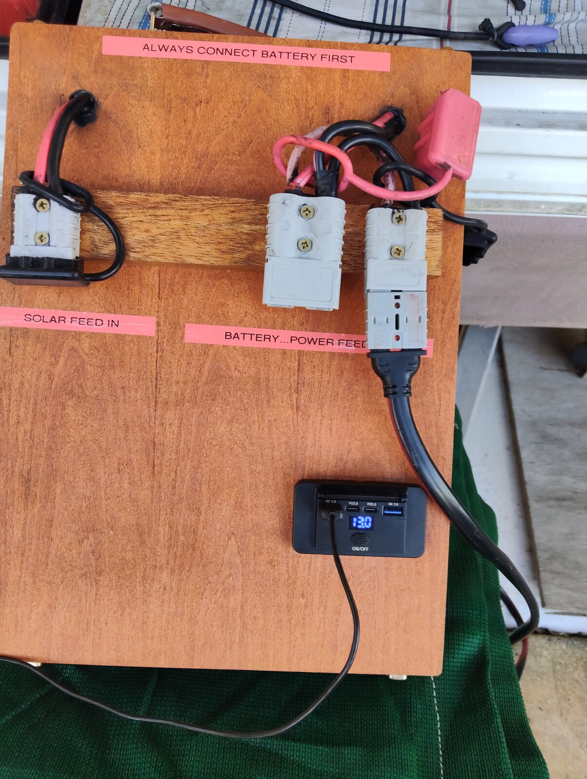

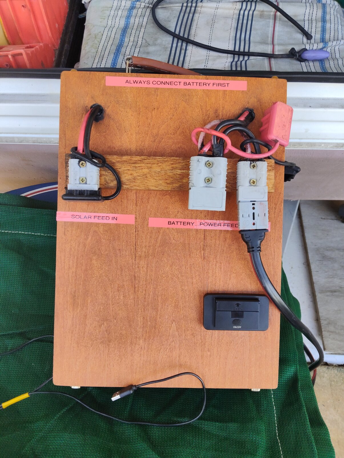

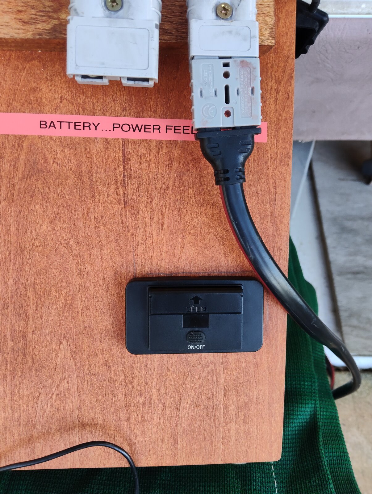

Is that between your battery and inverter ???? My inverter and battery use the same connection on the buss bar and I have a breaker between the buss and battery also added one on the solar input to MPPT makes it easier to shut off solar for maintenance..
Is that between your battery and inverter ???? ...between the battery bank and the bus bar.
Basically I have the 3 x 135amp Lithiums connected in parallel, theoretically 405 amps, each has their own 100 amp fuse at their positive terminals. I then have the 300amp isolater switch in that main lead from the batteries, between the batteries and busbar, so I can turn all power off totally from the battery bank...It is a "keyed" switch that is easily accessable from inside the van outside the battery compartment...from that isolater switch it feeds through a 50amp fuse to the busbar which connects all other van 12v systems including the BMPRO BMS...(it has other smaller inline fuses)...at that same "heavy" connection near the busbar I have a separate 240amp fuse leading to the Inverter power input.
The power to the inverter does not pass through the busbars at all, goes straight from the isolater switch through the 240amp fuse in the inverter feed, with the negative from the inverter connecting directly to the battery negative input at the busbar. The positive and negative busbars are only rated to 150amps.
I based the whole system on a max 300amp draw...100 amps from each battery to the 300amp isolater, with the 240 amp fuse to the inverter...I have noted it doesn't get even near a 240amp draw even while running the inverter up to 2100w...but...if something went wrong the 240amp fuse, or one of the 100amp battery fuses should fail before anything catastrophic...I hope!
...I can isolate the solar feed by pulling an Anderson plug at the MPPT near to the battery bank.

That is a set up, I don't even think I have room for similar .............
326
425
It is a bit squeezy!
13,280
20,087
That set up would take up my whole front boot and the cables I woudld need a mortage...lol,lol,lol.
