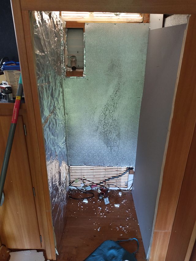

Up until recently my trouble free 3 way original had always done its job. Owned van for about 10 years.
150L RM2553 beige in a March 2012 16.49-1 Expanda Outback, stock standard cabinetry install. Never been touched at all, never missed a beat.

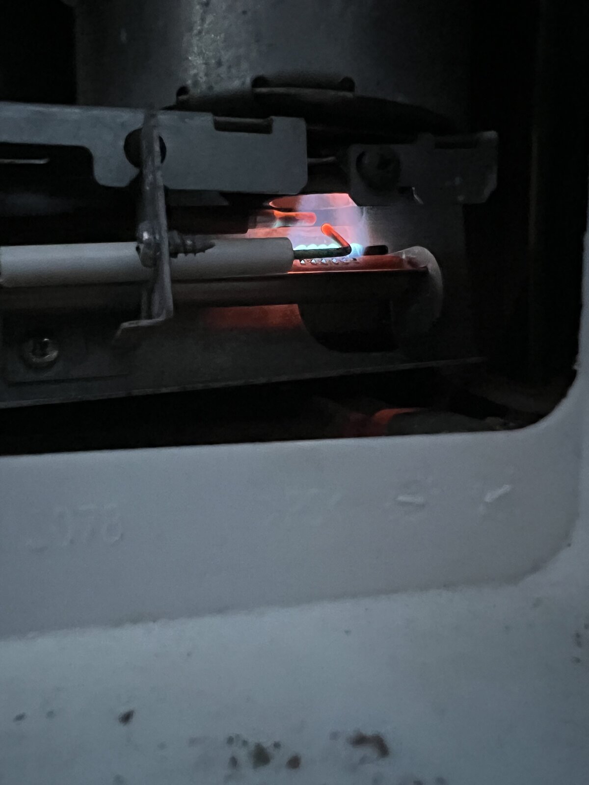

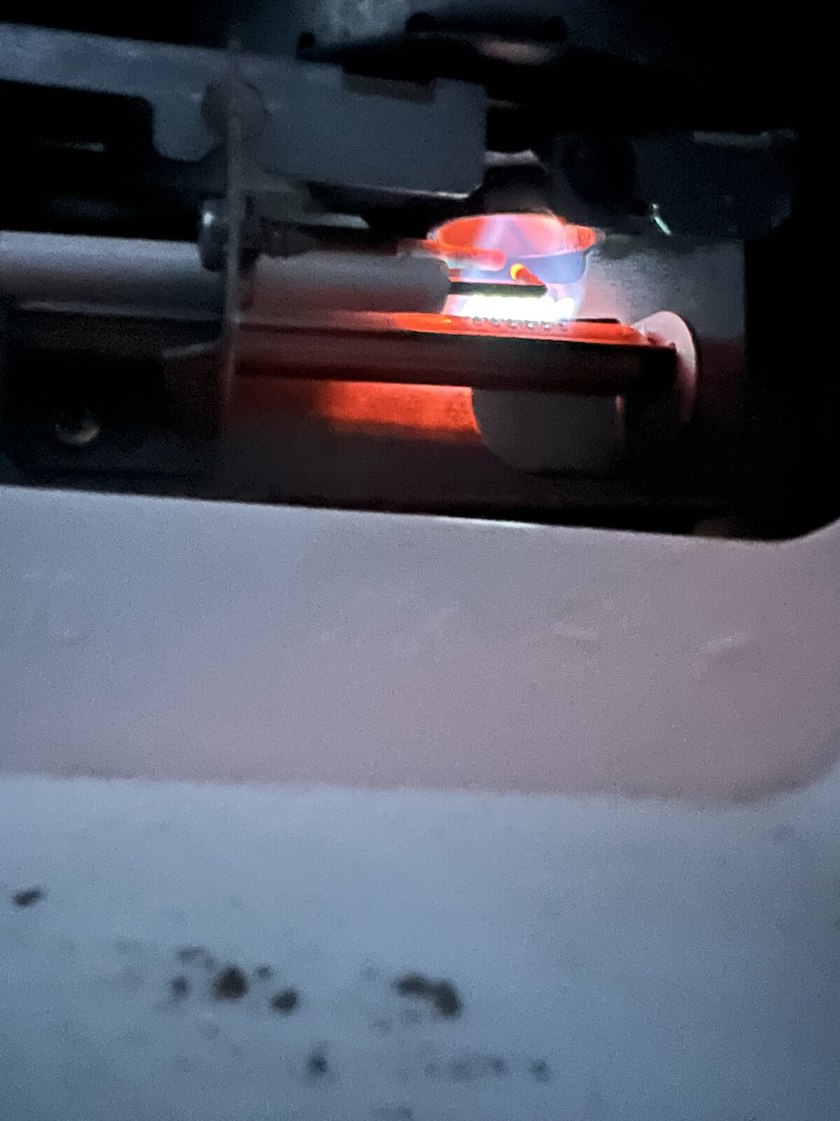

Gas full bottle. Piezo lighter and normal function of firing up via switch panel, flame burning bright, all visible when I took cover off, flu warm, 3 days running, fridge not cooling at all.

Thermostat on these manual jobs can be an issue, if you fire it up with thermostat set to coldest the gas burner should roar away at full noise and once turned to the warmest setting the burner should drop right back, been awhile now since Ive fiddled with one but I think we gave each setting a good 10 mins or so to settle , at the time it was the switch causing the problem, not expensive just a big pain to get at as the fridge does need to be removed .........
If its gurgling I think thats a sign of the refrigerent just not getting to vaporise, so thermo issue is the most likely if the flame doesn't vary in intensity ...

When mine went after some 10 years or so, it didn't cool but when I went to check at the back, Cats Pee hit me so I knew it was stuffed, if you pull the fridge out and have a close inspection of the back you may see a rusty crack in the fins/tank areas ...........
Repair at these ages I didn't think was a good idea so did a measure up and got a new one and while waiting for it to be delivered I gave the fridge cavity a remodel with proper insulation and sealing, upgraded my fan block ...
I looked at compressor fridge but while cost was similar the extra battery storage pushed it into too many $$$ and with proper insulation fitting mine now works just as good as compressor job ............. If you do replace look for a 2 door job if one will fit int he space as a decent freezer is a god send.

I'll try the gas flat out at start and then drop to low trick and see what that turns up?

You will have to run it on gas for a bit until the flu gets Hot anyway, then adjusting the dial should throw a change in gas flame ... I'm not sure how you would check using power though ... If the flame stays the same and the flu doesn't get hot to touch then it does look like the thermostat ... after an hour the flu should be hot,hot burnies ......
The flame won't be a biggie like on the HWS but you will see a change ...
