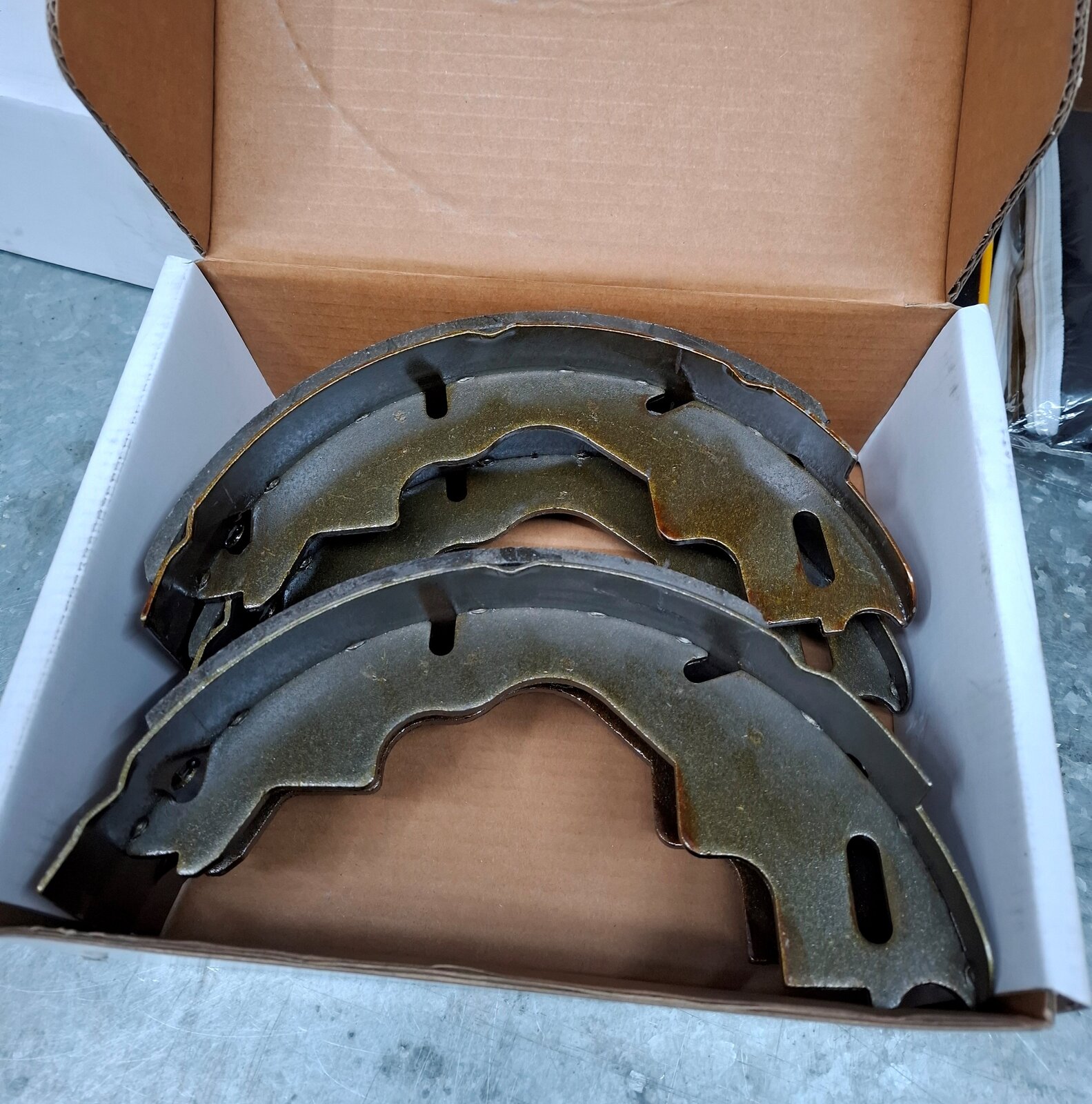

I picked up 2 sets of 4 brake shoes for $56.95 per set for the van...10" Alko...pretty happy with that...
...for the record these new ones have 6mm of meat on them, when I measured the shoes on the van they were at 4mm, so not quite halfway in reality. I'll swap them out anyway as I will be doing a trip to the Victorian high country later this year...plenty of hills to climb and descend so knowing the brake shoes are healthy will be nice...:)

I get my stuff from The Trailer Shop or Couplemate, while I check the bearings by the wheel shake unless it clunks I leave them alone, if been over a lot of dirt or floods then they will get pulled off but not so much nowadays always sealed so just the clunk test and brake adjust, once or twice a year, not doing the 10K km plus a year now ..................... but if one clunks I want to know why so they all come off, last done when I fitted new shoes and magnets last year ?? Car bearings will do a lifetime so why not vans ... if done properly.
Think the last shoes were originals along with the magnets so got a good run out of them but Im not a big brake man, preferring to use gears ... and the old yearly routine when running up lots of miles meant they got cleaned out regularly ...

I have bought stuff from The Trailer Shop as well as Couplemate, I bought these shoe kits from Trailersrus.
I have only towed this van a little over 37,000kms, and I know the previous owner did do a lap with it as well, plus a trip up to Gulf country, it was still under 4 years old when I bought it...so whether he had ever replaced brakes & bearings I don't know...I pulled the drums prior to the lap and greased all the bearings and would have looked at the magnets and linings then, but cannot recall what sort of depth they were at. I too am pretty easy on brakes using the car to slow and pre empting as much as possible...
