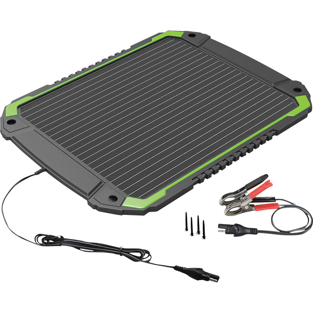

If you can't just leave it plugged in to 240v at the olds place then I would get one of those 2.5w - 5w portable solar battery chargers from supercheap and hook it direct to battery, throw panel on roof at a slight angle so crud washes off and you will find your battery will stay good for ages so long as it was fully charged in the beginning and disconnected from rest of van, these don't require a regulator just connect direct to battery........ mine have kept batteries charged that are higher A/H than detailed.....
Of course if your van has solar already then its not a drama .........
The other way is since your van battery is either GEL or AGM , when you drop your van off you just pull the battery out, take it home and throw it on a suitable multi stage charger to keep it sweet until next time, the charger just needs to be for your battery type and be about 5 stage so you can leave it to do its thing and forget about it, there quite a few out there that are not overly expensive things either........................... Being GEL or AGM it is quite safe to carry in your vehicle as they won't spill or vent nasty gas, just need to protect the terminals from stray contact with anything.......

Hey @Drover , I just had a read of the instruction booklet for the 2.5w - 5.0w solar charger you provided link for. It clearly states that solar panel/charger is NOT waterproof and should not be exposed to the elements. They do say fine to have unit attached to inside of car window or on dash board. I do not believe it would be suitable for @MelSurf to use for float charging van battery. Definitely better to remove battery from van and charge at home with a multi-stage charger as you said. Extracts from the link provided are set out below.
"This unit is not waterproof, and is most effective when placed next to a window with lots of natural light."
9. FREQUENTLY ASKED QUESTIONS 10. WARRANTY Q. Is the battery charger waterproof or water resistant? A. No. Please ensure that the battery charger is kept out of extreme weather or wet conditions.
