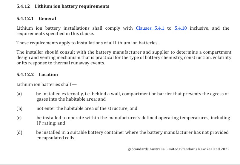

Remember the new standards/ regs around wiring as well. Major modifications require compliance. I don’t agree with all in the standards but there they’re just the same . Some of the things are easier to follow. Fuse within 200mm of battery . max number of connections to a battery. The hardest is enclosing and venting your batteries .

There is nothing in the ASNZS3001 standards about what the battery enclosure has to be made of. It only has to be sealed, fixed by fixings that have to be removed by a tool ( lock and key fit that description) and vented to the outside. A roto moulded plastic tool box with a 20mm hole through the floor achieves that. Venting is only required if the lithium battery manufacturer deems it. 5;4;1 to 5;4.10 relate to general battery requirements like max voltage of 48v, battery must be rechargeable , Minimum capacity of 40AHr at 20hr discharge rate, battery terminal connections type and markings, Securing of battery, Correct charger for battery type, Isolation switching and control, Labelling of battery installation, proximity to metallic lines for lpg etc.

As usual new regulations do not consider the potential knock on effect. I think the biggest issue now will be Insurance cover in the event there was a fire attributed to the Lithium batteries...all caravan policies now will include some sort of appendix with conditions...if the battery system was installed by some one other than the manufacturer...ie self

The new regs are more inline with toxic fumes besides most van batteries, well mine anyway, is LiPo4 so don't turn into a roman candle just have a melt down like AGM/GEL's, be more like a wiring or other equipment fault ............... and seeing the wiring on many vans over the years its a worry more don't go up in flames ......
