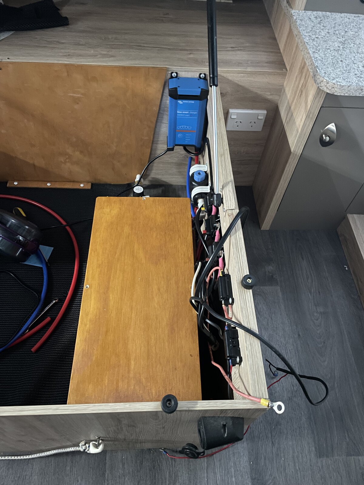

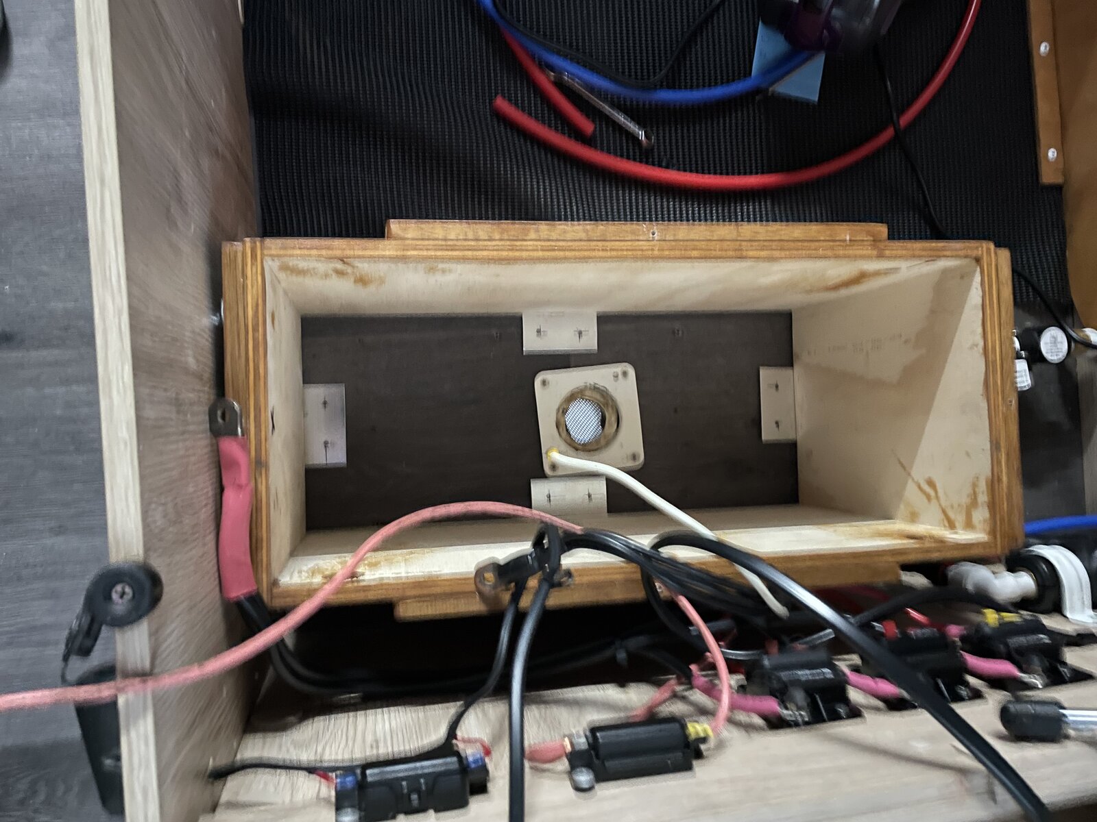

Well I’ve finally bitten the lithium phosphate bullet. I went 200ah Invicta Bluetooth, 30A Victron 240v charger, 2 x 200 Watt solar panels plus a Redarc 40A dc to dc + MPPT solar charger. All of this replaces the original electric/electronic/fuse box that died recently in Karumba.
After reading the new regulations (unusual for me I know) I’ve decided to leave the battery under the bed, I made a new box to replace the original plastic box that was vented under the van. Fairly happy with the way it turned out, I just have to pull it out of the shed and give it a test before I head off to Sydney then port Lincoln at Christmas, weather permitting.

Thats disgustingly neat and tidy ........................ something I never seem to achieve, always functional but never tidy........ Youv'e got all the bases covered there Dave.

Hmmm...very neat job indeed! I certainly haven't looked back since turfing the AGM's and installing Lithium Batteries around 18 months ago...though in my case was lucky to be prior to the update for batteries inside the van to be fully enclosed, as where they are under the dinette would be very difficult to effectively seal off from the living area.

I have seen somewhere that after that date if you go from say AGM to lithium then you are required to comply with the new regs, if inside a sealed battery box vented externally and another bit about over 3 solar panels each must be fused/breaker as well as a fuse/breaker before the controller .............. I have been contemplating an extra lithium for that extra bit of storage, would require a bit of metal bashing to extend the battery compartment and making a bigger slide to comply.............. another addition to the list .......................... I very much doubt there has been any compliance checks or will be in the future..

Phew I’ve only got two solar panels and everything is protected. Funny enough the breakaway had a 30a fuse at the battery when they’re supposed to have an auto reset circuit breaker I met the rules halfway and put in a manual circuit breaker so if the tow bar falls off I hope the wires don’t short out or I’ll be running alongside the van trying to get in and reset it

I doubt too that there would ever be a "compliance" check on older vans...do you reckon any savvy person would be honest with the "Inspector", and admit their whizz bang system does not comply? ...lol think not. It really just put the onus on manufacturers to be more vigilant with battery location and solar panel fitment post November 2023 imo.
I actually have an extra Lithium battery that I bought at the same time as the other two, and wouldn't mind fitting it just for extra capacity, but there is physically no room to fit it under the dinette. (I even have the MPPT mounted in a drawer under the dinette so as to be able to access it to read it.) The only way I could add another battery is to either move the whole system to under the bed or in to the front boot, or, run extra cables to another location to mount the third battery which isn't on the agenda. So I am locked in to the 270 amps I have...unless...I were to buy two bigger capacity batteries which ain't gonna happen anytime soon...lol...and so it goes on!
