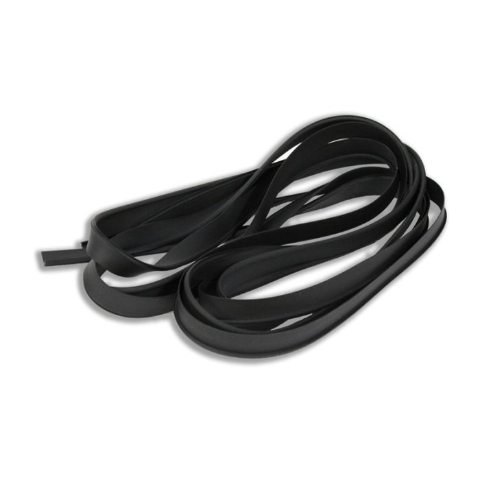

My camec door has some adjustment on the locking side that requires some patience to line up the 3 locking points. It also uses a rubber seal, sort of like this
that I have to frequently clean behind and check it is pressing against the door frame.
