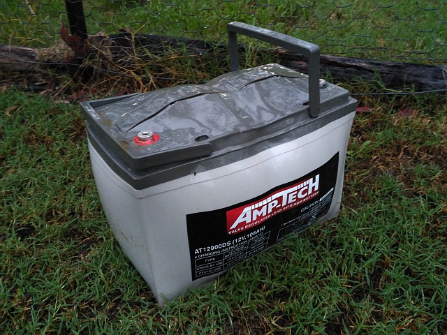

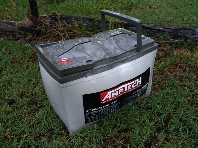

Its working, oh joy here;s a pic of an AGM which went China Syndrone on me years back......................
