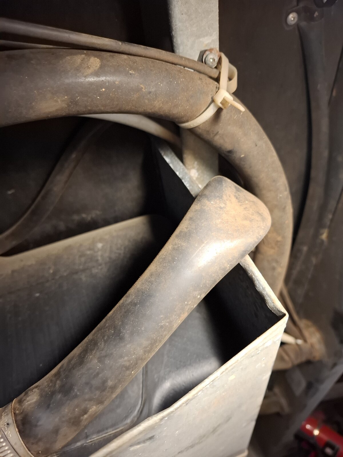

Thought I'd do some maintenance to figure why the rear water tank was sooo slow to fill...aha...
I found Jayco's way of making straight hoses go around corners!

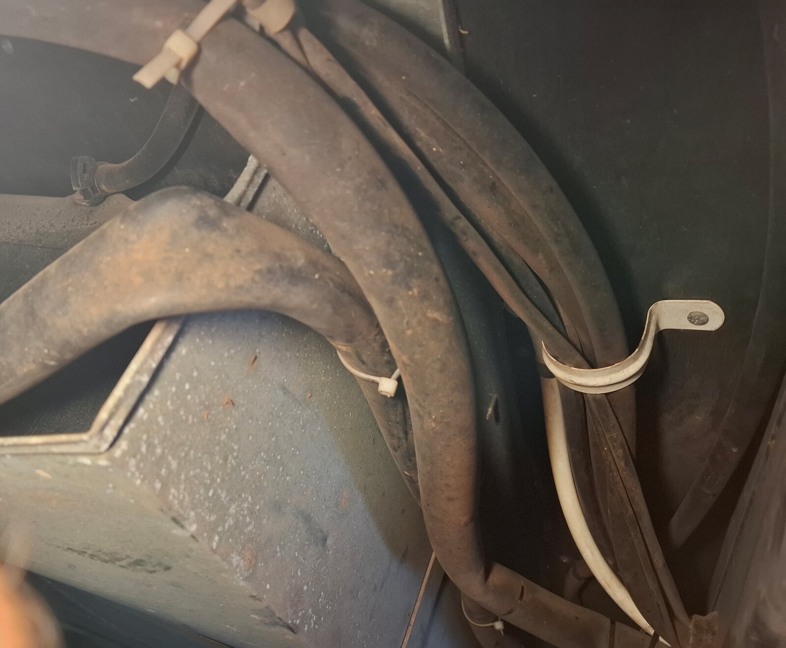

I too was perplexed initially when I bought this van, as the filler necks for the water tanks are back to front too...the front filler fills the rear tank where the rear filler fills the front tank...you wonder was it intentional or just another Jayco brain fade...
I cut that bent hose and installed a $10 elbow...tank fills easily now...
