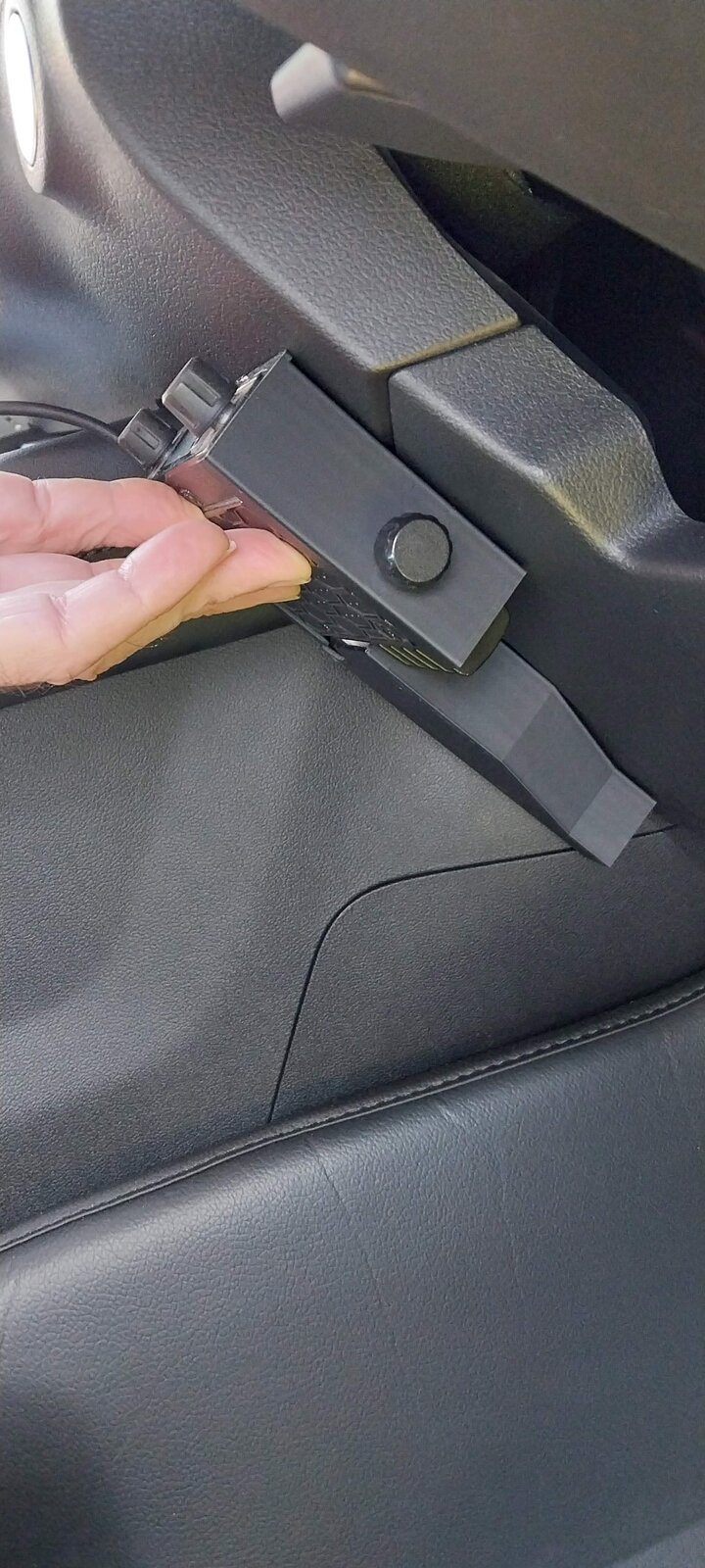

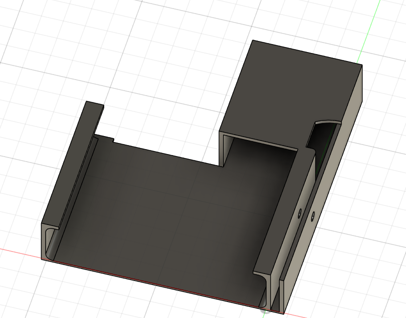

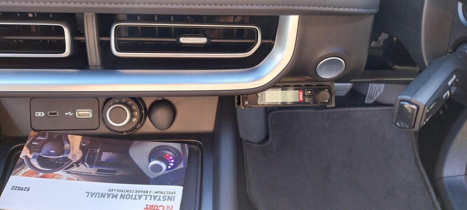

Screenshot 2025-07-27 154415.pngDesigned a low profile housing that I can stick on rather than screw. The channel is for the mic cable
20250728_113059.jpg First test fit looks ok from the top and well away from my knee
20250728_113045.jpg I printed a longer section to hide the cables. Looks a bit chunky in the pic....hope it works ok. Sadly, in the facelift model, they removed the little shelf under the steering column where it sits in the dmax
What do you think? Looks ok or try harder :oops:

Looks okay, so long as knee doesn't whack it .............................. Most envious regarding the printer, I often find one would be handy but would probably frustrate me more......... Stock springs will probably be too spongy as well so I wouldn't do anything major to the WDH untill you see how the suspension goes.... mate who just replaced his old BT for another went and reset his tow hitch set up, new shank and now finds the stock suspension is pretty ordinary so is upgrading it, something he had to do with his old one and we talked about with this one but he believed the dealer talk ................

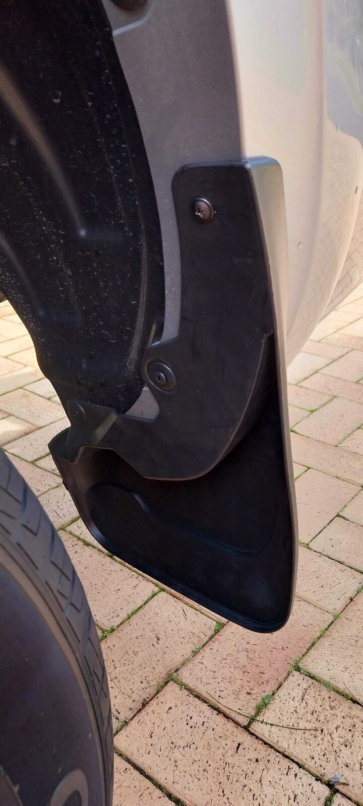

20250803_121353.jpg Aliexpress $20 mudflaps...no I don't know why they are not standard

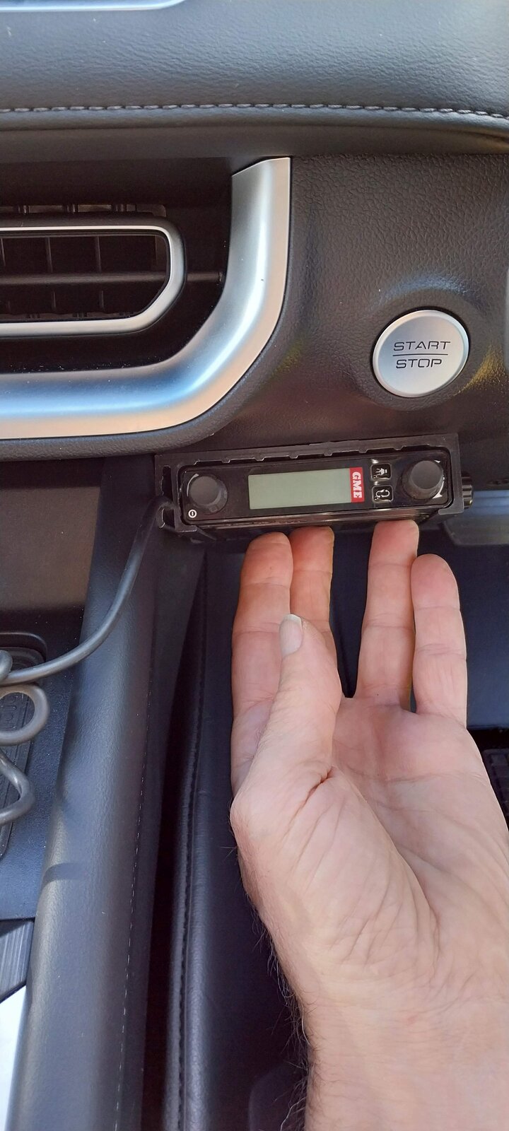

20250805_145525.jpg Curt Spectrum brake controller and UHF done. Going to miss the info on the Tekonsha but this unit is pretty clever

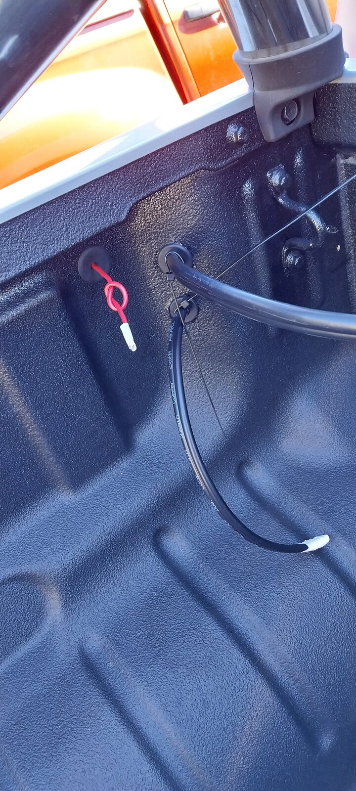

20250807_142053.jpgMuch crawling under the ute to run wires from the battery to the 7 pin...to the anderson...to the tub. Lower cablewill be the 25amp dcdc to the tub batteries, upper cable from the batteries to the tow bar anderson, red wire is ignition sense that I use for various jobs

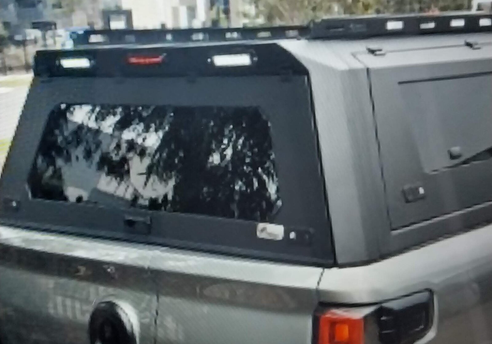

20250804_113015.jpgTrying out a canopy this time around. Wife didn't like the colour matched fiberglass so a black one it is. Have to wait a few weeks for it to arrive

I know what you mean, trying to do contortions to get at stuff, Im past it ....................................... I bought ebay mud flaps for the Jeep years back, $20 and the funny thing was they had the Jeep part number on them ...

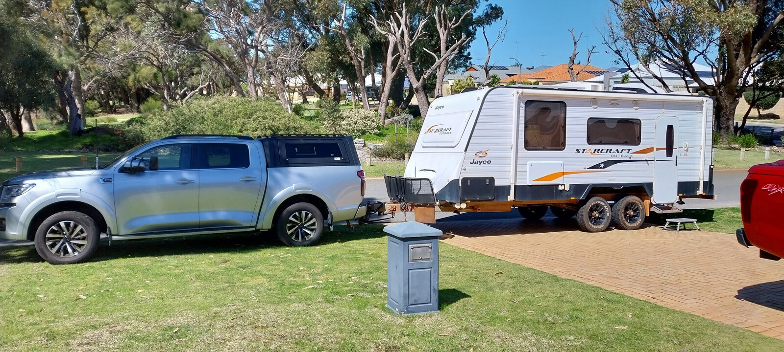

Decided to stick with what I trust and put the WDH on for the shakedown trip
Stock suspension is sitting ok and the extra power is just bliss from a standing start. The Dmax takes ages to get up to speed compared to this.
We've done about 1000kms down the south west towns, with 90% in the rain sadly. Fuel economy looks fairly similar around 18l/100km but need to check this when I fill up again. Brake controller took some getting used to but is working great.
Overall verdict so far. I'm happy with how it's going.
Need to change: A fill near empty is 65l compared to the dmax 110l so it will definitely need an extra tank or something - I need a minimum of 500kms of towing range up north. Probably install airbags once my Son's girlfriend (yay for a machinist in the family!) makes me some adapter plates. Lastly some A/Ts and a bash plate for the fuel filter - great for access but who decided to hang it so low!

I wouldn't add airbags unless upgrading the rear springs even with added chassis panels ... looks the goods ....
Those poly tanks that fit in the tub are a good option, no need for another mortage like the ones underneath.
